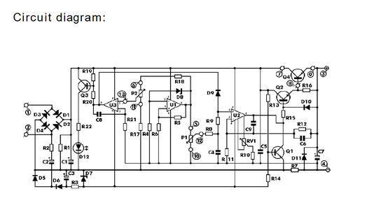

Step 2: Schematics

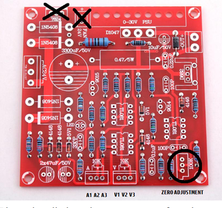

User manual for power supply Hiland is available on e-shop page of the seller here . From user manual is taken attached electronic scheme. This scheme and PCB itself can help during soldering all components on the board. From my experience, I can advice, to check all components very carefully. In my case I did check twice, but I have made small mistake anyway. Do not solder both potentiometer and limit LED on the board and solder just connectors. Original one turn potentiometer is used for current only. In this case resolution of current adjustment is enough. Voltage potentiometer is replaced by 10 turns precise potentiometer. Potentiometers and limit LED are soldered to wired connectors included in kit. By soldering both potentiometers be careful and solder them such a way, that increasing value on each pot is in clockwise direction. Current potentiometer is without pin numbers, but pin numbers are in the same position as it would be soldered directly to PCB, concerning attached numbering in the picture. Voltage potentiometer numbering is signed on pot, but numbers of both potentiometer on schematics are not correct, there is swap pin2 and pin3.
On the board Hiland is not soldered 24V regulator and socket for fan. Both places are marked by cross. The reason is powering fan from other source, power adapter and to avoid touching regulator 24V to cooling heat sink.
Scheme of Small power supply is on picture. It contains all modules, components outside modules and all wires between them. For powering meters modules, there is necessary to use another power supply to prevent from short circuit connection. It is the only way how to connect both modules to the Hiland power supply board and to the extra power source for them. I use old power adapter for mobile phone. Adapter is connected to 230VAC on one side an deliver 12VDC on other side. From this adapter is powered 12V fan as well. Total current consumption is about 200mA and could be chosen any adapter with power more than 3W.
Ammeter module is connected in back minus line. Current from minus output connector is fed through this module and therefore is plus pin of current for this module, connected to minus output connector.

- Adjust pot 100K (right front side of board on attached picture) exactly to 0 V.
