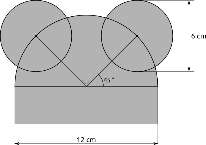

Step 6: Mounting the Shafts
Now there are two sets of wheels of which two are glued onto a driving shaft and two are attached to the discs.
The infrastructure onto which the shafts and wheels are mounted are two pieces of cardboard. The shape of the cardboard piece is constructed by drawing two circles with a diameter of 5 cm with their centers 7 cm apart on cardboard of 1.5 mm thick. (Note that this shape is probably too broad, as I have noticed fine, thin arcs jumping from the combs to the cardboard. perhaps 3 cm wide circles would have been better. See the "Debugging" step on how I prevented those small arcs. )
Holes are drilled and enlarged into the centers of the circles so that the driving shaft and the disk shaft can be inserted and rotate freely. (Although it is not necessary for the Disc shaft since the disks themselves can rotate freely around the shaft)
For each side two small circular spacers (0.5 mm thick cardboard) are cut out and so are some circles cut out of baking paper to reduce the friction.
The shafts can then be mounted into those pieces of cardboard.
Nothing is glued in this step so everything can be unmounted again.
Then finally rubber bands can be added. On one side, a rubber band simply goes around both wheels. And on the other side, make the rubber band cross itself.
This will have the effect that when the driving shaft is turned, the two disks will rotate in the opposite direction.

Step 8: The Base
A ground base is cut out, this will be used to mount everything on.
The shape is based around half a circle with diameter 11.8 cm. On the straight side of the half a circle there is an extra rectangular area with the same dimensions as the bottom of the socket for the mechanism.
On the curved side, two circles with radius 6 cm with their centers on the crossing of the curve with a radial lines with a 45° angle with respect to the straight edge. These will be the locations for the Leyden jars.
This is a bit complicated to explain in words, so I will provide a schematic:
Schematic of the base
