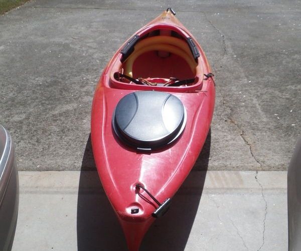

There are many designs of wheels for canoes on the internet made from PVC tubes and this is what I did for my Perception Prodigy 10 and the design can be adapted for most kayak styles. The wheels are small and at towards the rear so you still need to support some weight when pulling on the front toggle but is one of the smaller compact design which is better than dragging or carrying it to and from the car to launch site or on portages.

Set the frame and wheels on your upside down kayak and tie two loops of rope through the frame. Loop the first shorter one over the end of the kayak looping it around the carry toggle or use a carabiner to latch to a feature. This holds the frame up against the hull. Then loop a longer piece through the frame and around both sides of the kayak. Turn the kayak over and tighten this second loop around the front of the cockpit to tension and hold the wheels in place. So as to not have as long a loop and less stretch in the rope I threaded an old bungie cord hook on to the rope and hooked this onto the rear of the cock pit instead. A carabiner hooked into the cockpit or other deck feature would also work.
