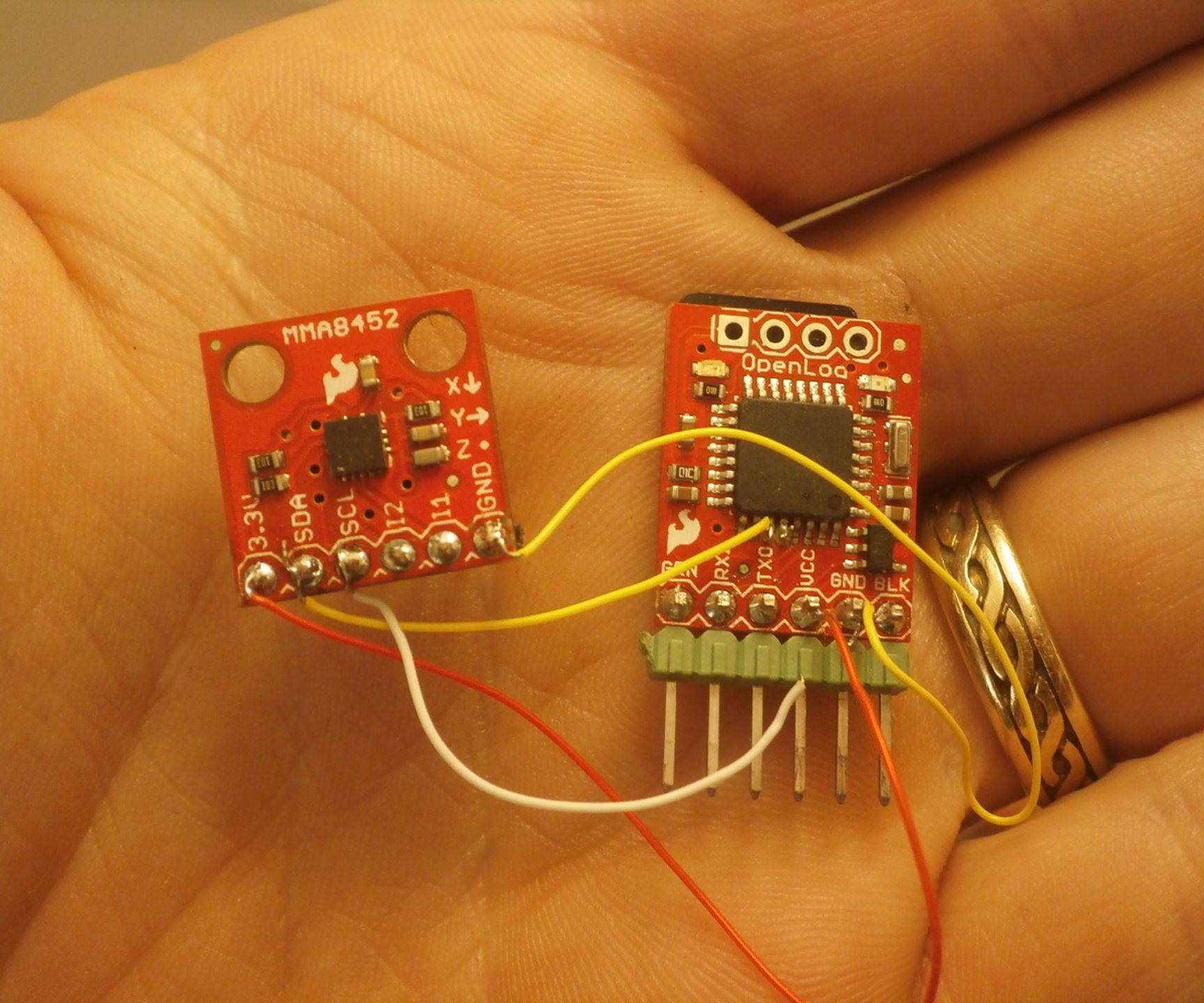

This is my first pass at a very small e-reader using an oled screen and an arduino. The goal is to read any text file from an SD card with a form factor < 1 square inch.
This instructable is only the very basic setup, it does not include the SD card.

Step 2: Wiring
Here is the wiring from the OLED to Arduino UNO or MEGA
OLED to Arduino
CS -----D9 (slave select)
MOSI---D11 (spi bus)
SCK---D13 (spi bus)
Reset---D8
DC ----D6
note - D10 set to output for ArduinoUNO (D53 to output on MEGA)
Here is the compatible wiring to add an SD card (I HAVE NOT TRIED THIS YET 1/11/15)
SD ---- Arduino UNO ------TQFP Physical Pin
CS -- D10 (slave select) ------- P14
MOSI -- D11 (spi bus) -------P15
SCK -- D13 (spi bus) --------P 17
MISO - D12 (spi bus) --------P16
CD - D2 -------------P25
