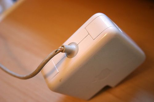

1 - 240v to 12v transformer (I used an old laptop power supply)

Then you want to attach the output leads of the transformer into a junction box i had 4 a 12v and a 5v but if you only have 2 it is the same process prior to this I plugged in the transformer and found out which lead did what the right two are positive and negative 12v. This is shown in the sixth photo I switched the live wire but you could just as easily switch the neutral. The live (white) wire is connected to the relay i used a junction strip because I also wanted to put 240v through it. Then take the neutral wire and attach it to the neutral lug of the stereo jack socket in my case it was the middle one but when you look at it side on it should be divided into three layers the top layer will be the neutral layer. The 12v output form the transformer is the switched one and this is attached to the lug on the second layer of the output jack the put the 5v onto the third lug of the output jack, it doesn't matter which ones the 12v and 5v are on but the neutral must be on the correct one.
