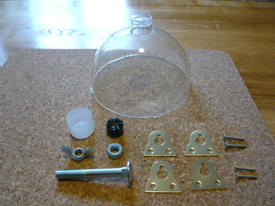

Parts:
Baffle (in this case the top of a solar powered garden light, but the top half of a large bottle could be used, the larger the better).
Bottle top/cap.
Large metal bolt (preferably one which is longer than shown, but with not too much thread which hinders rotation).
Hexagonal nut and butterfly nut, that fit the bolt.
Several washers taped together in a drum, that fits on the bolt (this acts as a rotating bearing).
4 wall brackets (having a middle hole that fits bolt, and two small holes that fit the fixing screws).
4 Screws.
Small feed tray (not shown till later).

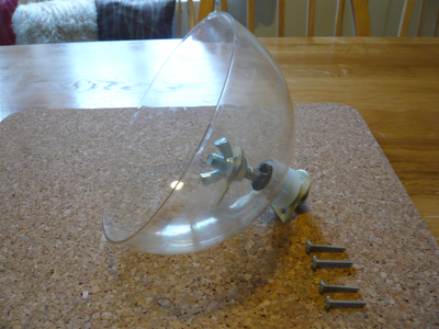

Put two brackets on the bolt.
Put the bolt through the bottle cap (you will need to drill a hole to match the bolt diameter).
Screw the cap on the baffle.
Put the drum of washers on the bolt (drum acts as a bearing), this should nestle in the neck of the bottle.
Make sure the baffle can freely rotate on the bolt.

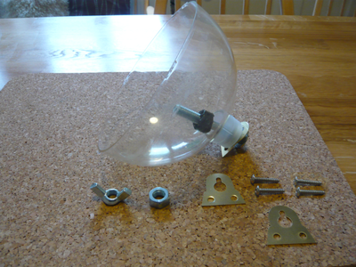

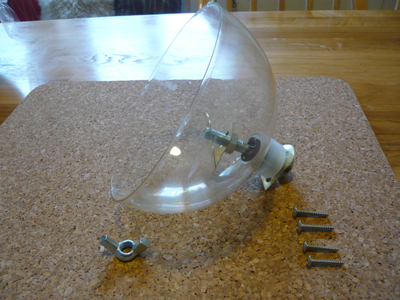

Step 3:
Put the hexagonal nut on the bolt.
Then add the two remaining wall brackets to the bolt.
Step 4:
Screw on the butterfly nut (or a hexagonal nut) onto the bolt.
Step 5:

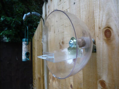

Place the bird feeding tray (in this case a small tin) between the two jaws made by the two wall brackets and tighten the butterfly nut to secure tray in place.

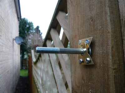

Step 6: Mounting the Bracket to a Post
First mount the brackets onto a wall/post, keeping the bolt horizontal.
It is best to do this first to ensure that the screws can screwed in easily.

1) A longer bolt (e.g. a roofing bolt) could be used. However, do not use a bolt with too much thread as this can hinder the rotation of the baffle when the thread is in contact with the baffle (I'm currently using an eight inch roofing bolt which has about an inch and a quater of thread). If using a longer bolt, you might need to place a cable tie on the shaft of the bolt just behind the end of the bottle cap, to prevent the baffle moving back along the bolt towards the wall. This tie can be added after the kit is assembled, obviously trim off the excess tie to make it look neater. A longer bolt will need to be more securely anchored to the mounting surface – simulated the weight of a squirrel hanging off the end of the bolt!

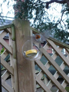

Step 10: Happy Customer!
Birds can enter the feeder from the front.
Squirrels can't get a secure foothold on the feeder as the baffle rotates.
