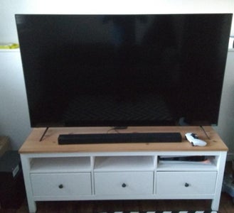

I got this Ikea HEMNES, but I was a little disappointed with the small size of the upper shelves. Just look at how the PS5 barely squeezes in there! I thought, what if I swapped that space in the center, so that the shelf is roughly the size of the drawer, and vice versa? And with the One Board Contest, it seemed like a good way to try to accomplish that!

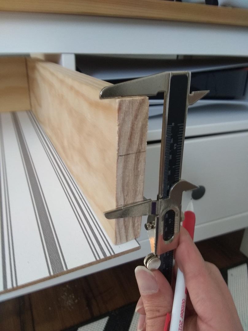

Step 1: Cut the Board

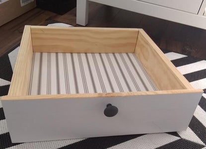

This is pretty straightforward. I measured the dimensions of the original drawer to size my board, then cut it with a handsaw. I would have preferred a table saw here if I had one available in order to get a more square cut, but the pine is at least relatively soft and can be cut through with a handsaw without much effort.
Step 2: Assemble Main Frame of Drawer

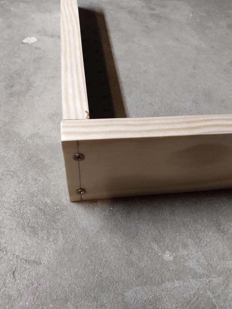

While the original drawer had some fancy plastic pegs with a nice smooth head, I opted to go basic here with some wood screws, since they'll be at the back of the drawer where they aren't really seen. For this part I pretty much just eyeballed where to drill the holes, and then assembled while against a square to try to keep it as square as possible. This is where not having a table saw hurts a bit, since it would be more foolproof the more perfectly square the boards are. In the end it wasn't perfect, but it works.
For the roller rails (which come from the original drawer), this was also tricky to line up exactly. On the original, the back of the drawer had a groove at the bottom for the bottom sheet. I have no groove, but the rails are meant to fit with the bottom slotted underneath. I did this, and lined it up as best I could in the back against the back board. It's important here to keep the rails at about the same distance so they'll roll smoothly. An extra hand would've been helpful here, but I did my best to hold it together in the "correct" spot, then mark the spots for drilling. Once marked, drilling and screwing it on is pretty simple.
Step 3: Check the Fit
This step is just a quick check that our drawer shape and the rails are going to work out before we proceed. I slid it onto the stand's roller rails in their original position. It works!

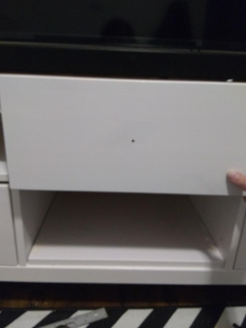

Here you can see the front board from the previous step has been cut down. I used a jig saw here since it was too long of a cut for the hand saw - again, it's not the ideal tool, but it does the job decent enough! In this pic I'm again holding it in place, it's still not attached.
You'll see in the next step why I used the original front instead of the same board, because I wanted the drawer bottom to have somewhere to slot into. Plus it gives me a little added height in the front instead of being uniform, and it's already painted (I don't have any white paint at the moment).

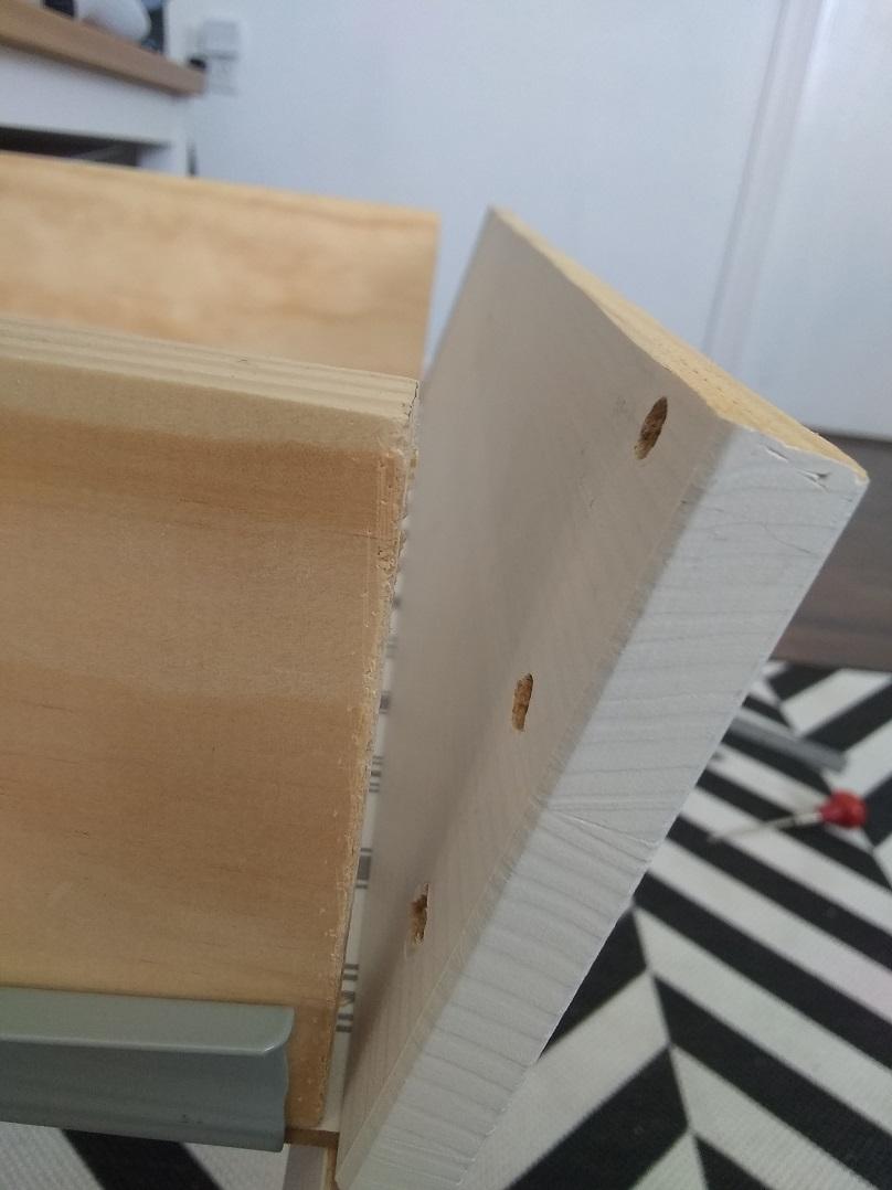

  • I don't have the proper tools to make holes for the metal nut thingies (I don't know what they're called, but if you're familiar with Ikea furniture you may know them), so I had to rely on just the dowel pegs.
To do this, basically I had to hold up the front to the drawer, then trace lines around that. Then I used those lines to measure to the center of the existing holes on the front board. Then I took those distances directly to the drawer boards. So in a way I basically transferred measurements from the drawer sides to the front and back to the sides again!
Drilling the holes was pretty straightforward except that the dowels seem to be between two sizes of bit that I had. I started out with the smaller bit but then moved on to the bigger one. This made it so the fit was not super snug.

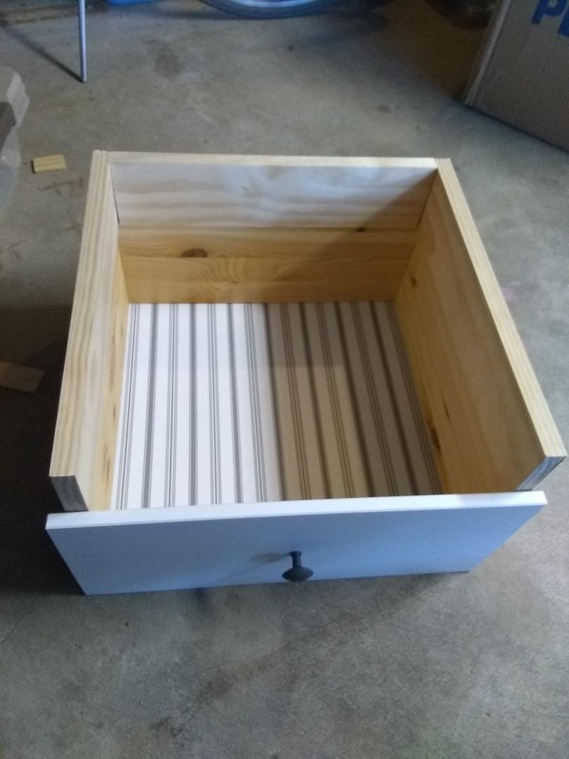

Step 7: Assemble!
If everything lines up, you should be able to just push the front onto the rest of the drawer, joined with the dowels. I put some wood glue on the dowels due to the aforementioned problem with the drill bit size. It's not perfect, but for a quick project with limited tools, it works!
