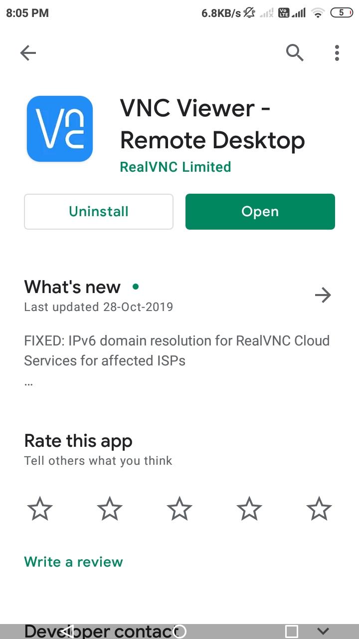

Step 8: Ip Address and Vnc App
- Take your cursor on wifi logo you will see ip address.
- Note down the address we will use it in vnc viewer.
- Download vnc viewer apk from play store.

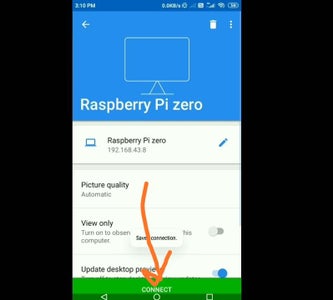

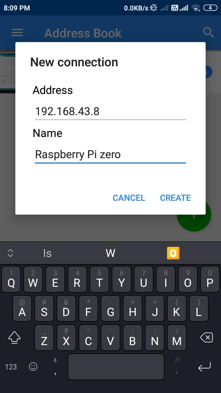

Step 9: Add Pi in VNC Viewer
- Open Vnc viewer and click on add button
- Enter ip address which you seen on wifi ion.
- Now enter name as you want
- Click on create.
- Now click on connect.

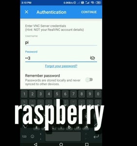

Step 10: Enter Username and Password
- Enter username "pi".
- Enter password "raspberry"

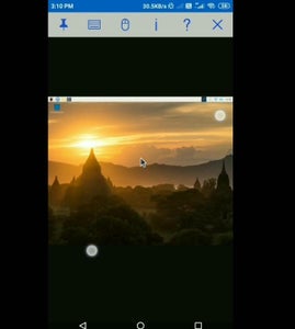

- Now you can seen your monitor screen on mobile.
- Now you no need hdmi or keyboard or mouse, just power on wait til it connects to wifi and you can connect it on vnc viewer.
