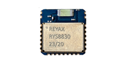

Step 3: RYS8830:
The REYAX RYS8830 1.8V GNSS module is built on the high performance of the SONY CXD5605AGF GNSS engine. The RYS8830 module utilize concurrent reception of GNSS systems offering high sensitivity in a small SMD form factor.
FEATURES:
  • SONY CXD5605AGF multi-GNSS receiver for GPS, GLONASS, Galileo
  • Small SMD form factor 121mm^2
  • Enhanced GNSS Filter and Low Noise Amplifier
  • Ultra-low power consumption
  • Up to Position accuracy 1.0 m CEP
  • Embedded Antenna
  • Optional external antenna

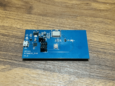

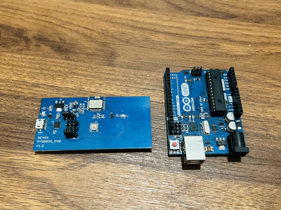

  • RYS8830 EVB or Custom PCB
  • Serial interface IDE (Arduino IDE)
  • 5V battery power supply
  • Jumpers and wires
Step 6: Getting Started With Serial Readings:

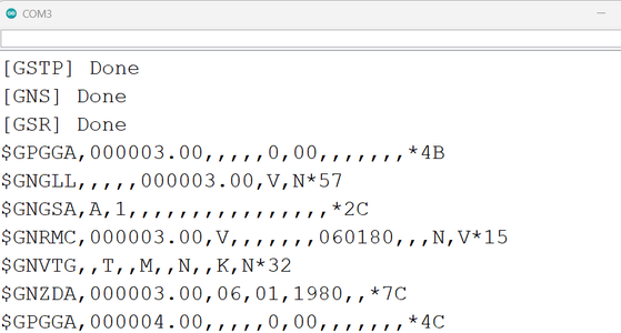

To quick start and get the GPS readings immediately, Connect the EVB shield to laptop directly and open any Serial to USB communication IDE. Here I am using Arduino IDE which has a better interface and can print the readings on the serial port.
Here are some quick commands to start the GPS after establishing the connection with any COM port. Just open the serial port and type these commands.
1) @GSTP
2) @GNS 47
3) @GSR
This will stop the position first at one instant and then second command establish the connection for positioning and time. GSR command will hot start the module so it will take less time to configure, if it not works then go automatically for warm and cold start method discussed in brief above.
Step 7: Getting the Serial Readings:
You will get the instant readings of different positioning systems in the serial monitor and it will take some time (usually 1-2 minutes) to give accurate readings. Then search for GPRMC and GPGGA reading. To decode the data from these readings, open online GPRMC and GPGGA decoder and paste the code there. This weird looking string has a lot of information (location info) so do not share with anyone. You will get co-ordinate readings with positioning in google maps.

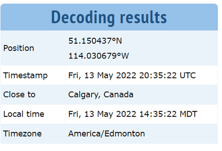

Step 8: Decoding the Data:
As an example I am taking a random string from the internet of GPRMC and GPGGA which redirects to the Canada Country. This will tell the exact position differ by only 10-50 meters. It is the best decoder tool I found on internet which not only decode the co-ordinates but also gives the point location in the map.
