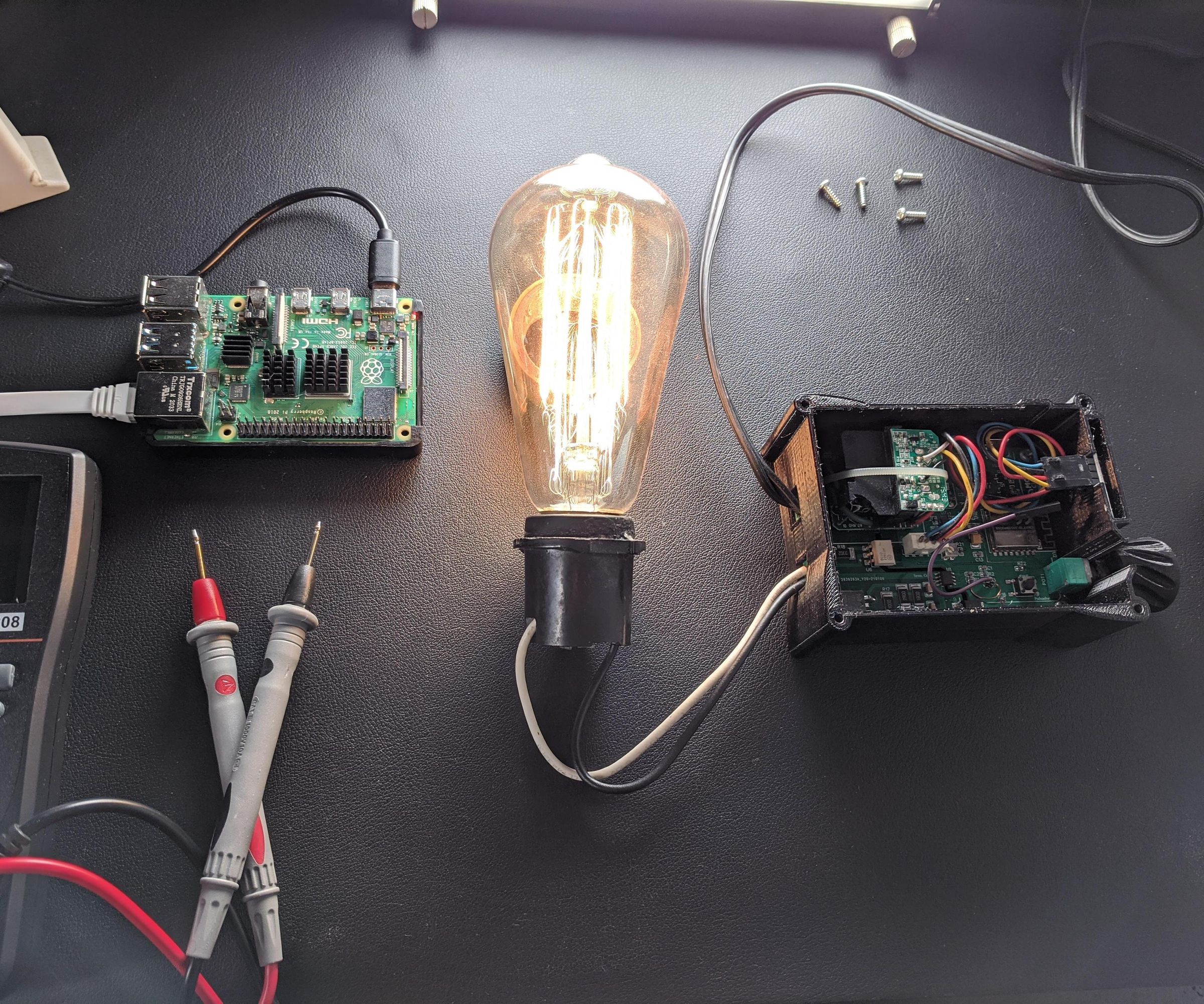

As you can see in the first picture, the system is up and working but not connected to the wifi yet, for that follow these steps:
- Press the config button for 1 second.
- A wifi network called ESP32-MCMeter will show up, select it in your phone.
- A portal will appear, click on config wifi and enter your wifi credentials and historic KWh usage.
- Click on save
- Finally press the config for 7 seconds to reset the system.
- Now it should be connected to your WiFi and sending data to the server in Home Assistant

Here you can see that I compared the measured data with the data shown by the system and they almost match perfectly, so the system is precise enough.
