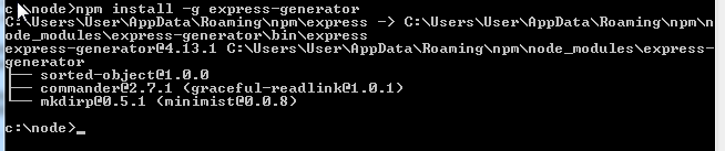

5. Install Express generator, like this:
COMMAND C:\NODE\
npm install -g express-generator
6. Create an express project named as attendance by following command
COMMAND C:\NODE\
express attendance
If success you will see something like this:

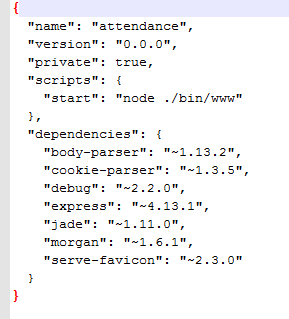

By this command express only auto-generate a website skeleton in a new directory called attendance. So we have to do some more work on it. You'll note that the express-generator routine created a file called package.json in your attendance directory. Open this up in a text editor and it'll look like this:
This is a basic JSON file describing our app and its dependencies. We need to add a few things to it. Specifically, calls for MongoDB and Monk for our database application. Let's make our dependencies object look like this:
Note that a comma is added at the end of the serv-favicon line and last line monk has no comma.

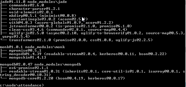

7. Switch back to your command prompt, browse your attendance directory, and type:
npm install<br>
Wait for a while, if you see the final output as like as follows then congratulation! You now have a fully-functioning app ready and waiting to run.

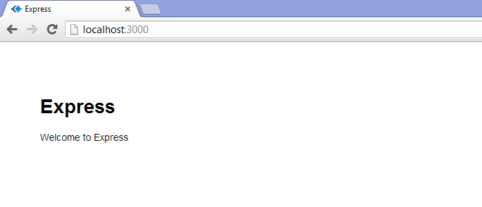

Everything working? Awesome! Open a browser and head for http://localhost:3000 where you will see a welcome to Express page like following.
