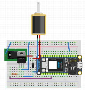

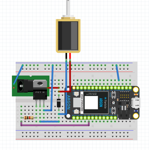

Step 1: Assemble the Breadboard
Start with your Particle Argon on the breadboard, and orient the board so the Argon is on the right side.
First, we'll place the important components we will need. It'll be easier if you also reference the image of the breadboard.
  • Place the power input connector on the top left of the board
  • Place the left pin of the mosfet at E5, with the black side of the mosfet facing towards you.
  • Place the left leg of the resistor at B1 and the right leg at B5
  • Find the line on the diode and place the leg of the diode closest to the line side at G9, and place the opposite leg at E9.
You've now placed all the components! Now we just need to connect them all with wires.
  • First we will run the wire that will toggle the mosfet. Run this from B19 on the breadboard so it connects with the Digital 4 pin on the Argon. Then connect the other end to A1.
  • Now we'll run the ground wires.
  • Connect the ground pin of the argon, or the breadboard coordinate J27, to the ground rail of the breadboard.
  • Then connect the rightmost pin of the mosfet (for example, C6 on the breadboard) to the ground rail of the breadboard.
  • Then connect the ground pin of the power input connector to the ground rail of the breadboard.
  • Now run a wire from the positive pin of the power input connector to the leg of the diode closest to the line side of the diode.
  • Run a wire from the middile pin of the mosfet to the leg of the diode without a line.
If any of this is confusing, please reference the images above.
Step 2: Add the Solenoid
Attach the crimps to the terminals of the solenoid and insert the stranded wire. Then crimp the wire with a crimping tool. Make sure the connection is strong by tugging on the wire a bit.
Step 3: Complete the Breadboard
Attach the solenoid to the breadboard by intersting the ends of the wires in-line with each end of the diode. The positive wire goes on the line side of the diode and vice versa.

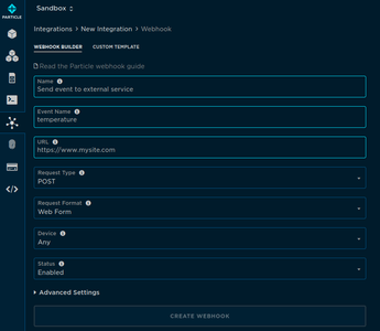

Step 4: Creating Webhooks
Now we need to make 2 webhooks, one for getting the rainfall predictions for the future and the other for getting the rainfall data from the past.
For each webhook, you'll need to go to https://console.particle.io/integrations and click "Add new integration" in the top right corner. Then click Webhook.

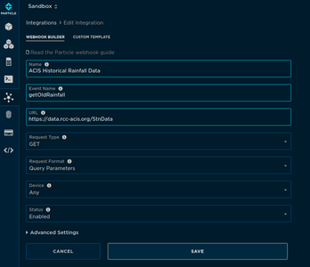

Step 5: First Webhook
The first webhook will be for historical rainfall data.
  • You can name it whatever you want, I named mine "ACIS Historical Rainfall Data"
  • The event name should be set to getOldRainfall
  • The API url should be https://data.rcc-acis.org/StnData
  • Make sure it is a GET request

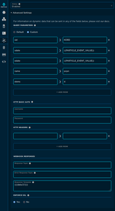

Then, click Advanced Settings and scroll down.
  • Set Form Fields to Custom, and add 5 rows.
  • The rows are:
  • sid > KORD
  • (this is the airport code for the nearest airport to me, O'Hare Airport. change this depending on where you live)
  • sdate > {{PARTICLE_EVENT_VALUE}}
  • edate > {{PARTICLE_EVENT_VALUE}}
  • name > pcpn
  • elems > 4
  • Then scroll all the way down to Response Template.
  • Add {{{data.0.1}}}
Then click Create Webhook.

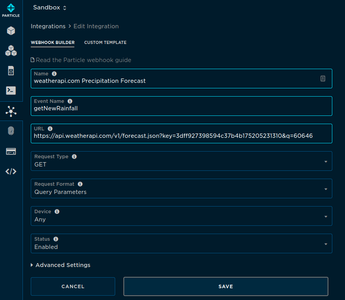

Step 6: Second Webhook
The second webhook will be for rainfall predictions. For this, we'll use weatherapi.com.
First, go to https://www.weatherapi.com and click Signup. Once you've done that, find your API key on the account dashboard.
The webhook URL will be https://api.weatherapi.com/v1/forecast.json?key=yourapikey&q=yourzipcode
Once you have that, we can make the rest of the webhook.
  • You can name it whatever you want, I named mine "weatherapi.com Precipitation Forecast"
  • The event name should be set to getNewRainfall
  • The API url should be what is written above

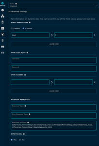

  • We only need one row:
  • days > 3
  • Add {{{forecast.forecastday.1.day.totalprecip_in}}},{{{forecast.forecastday.2.day.totalprecip_in}}},{{{forecast.forecastday.3.day.totalprecip_in}}}
