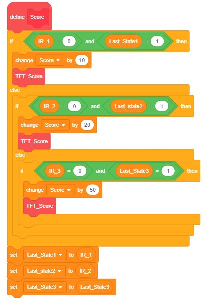

The nets that we made in the previous step are the dumb nets. They cannot count the shoots you did in each basket nor can give you the score. How about we make the nets that give us the score by multiplying the number of times the ball has passed through the nets to the score assigned to them.

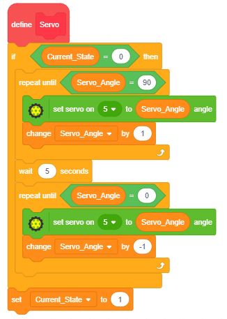

Once done, take the small cardboard door and attach it to the servo horn. This will give you a fixed number of shots. How? The balls collected won’t pass through the gates until and unless you open this door. Those, we will code it in a way such that the door opens only at the beginning of the game so that all the balls get collected into the ball holder. As soon as the game starts the door closes.

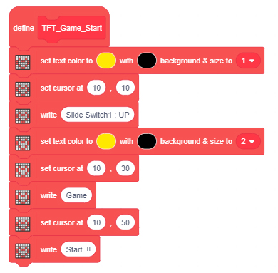

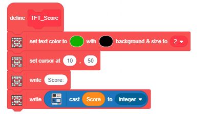

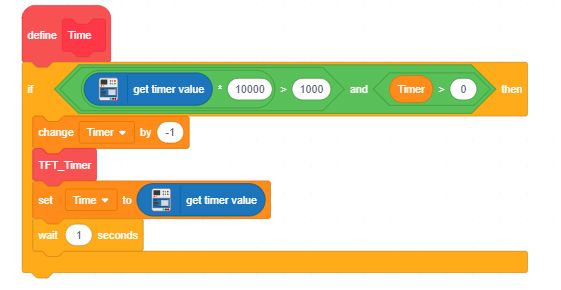

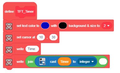

We are going to display the messages, score, and timing on the screen.

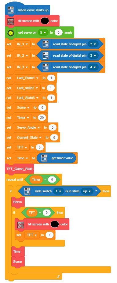

Step 12: Time to Code
To code it in a simpler way, we are going to use PictoBlox, a graphical programming software.
You can write the following script or directly upload the code given below:
