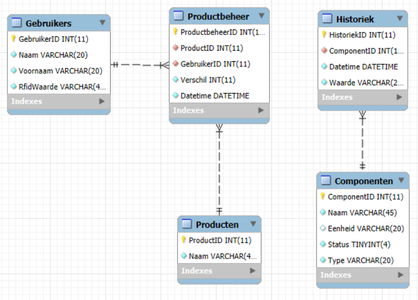

Step 2: Database
I used MySQL Workbench to design and manage my database. My database keeps track of product changes by specific users (via RFID), logs sensor readings, and maintains historical data for accurate inventory and usage tracking.
To set up the database yourself, connect to your MySQL server via SSH and create the database structure based on my schema. If you encounter any issues or prefer a ready-made script, you can use my SQL file on my github.
https://github.com/howest-mct/2024-2025-projectone-mct-VerslypeBram/tree/main/data
You can find the file in the link above, under 'data'. It contains the complete schema and all relationships as designed in MySQL Workbench.

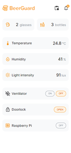

Step 3: Programming the Project
This is where your project really comes to life. In this step, we’ll program both the frontend (what the user sees) and the backend (what happens behind the scenes). You’ll also learn how to connect and control the various sensors and actuators, and how to send and display real-time data through your web interface and database.
Frontend
I started by creating three sketches on paper to visualize how my website would look. Afterwards, we brought these sketches to life by designing them in Figma with colors and details. Once the design was complete, I began coding the frontend using HTML, CSS, and JavaScript. This shapes the look and feel of your web dashboard.
Feel free to create your own website, but if you want to use mine, the file is available in the link below.
https://github.com/howest-mct/2024-2025-projectone-mct-VerslypeBram/tree/main/front
Backend
The backend is built with FastAPI for handling API endpoints and Socket.IO for real-time updates to the frontend. The main logic in BeerGuard.py manages hardware interaction with sensors (temperature, humidity, light intensity, weight...), controls the ventilator, electric lock and LCD, and processes user inputs like RFID scans.
Background threads continuously monitor sensors and update the system, while the DataRepository handles database communication using MySQL. The backend also supports safe shutdown of the Raspberry Pi.

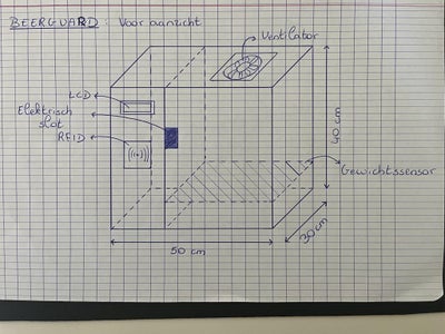

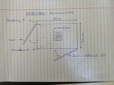

Step 4: Design BeerGuard
Before you start building the enclosure for your project, it’s best to make detailed drawings of your design. This allows you to visualize exactly how your project will look and helps prevent mistakes during assembly. In the photos, you can see both the front view and the top view of the enclosure. This preparation also makes it easier to communicate your ideas with others or to make adjustments before starting construction. Taking the time to plan thoroughly can save you a lot of effort and material later on.

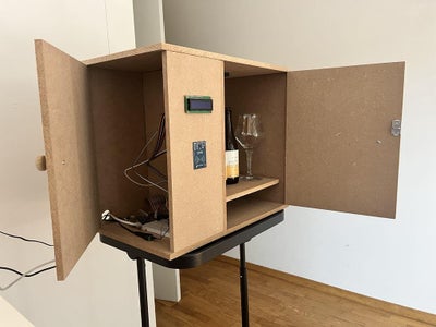

Step 5: Building BeerGuard

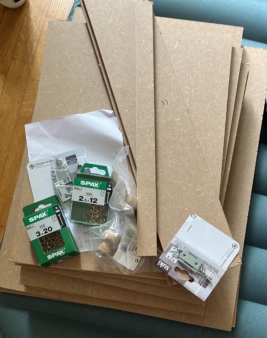

To begin, I had all the MDF panels cut to the required dimensions (see photos for the exact heights and widths). The next step was assembling the project. Here’s how I proceeded:
- I started by screwing all the outer panels together to form a rectangular frame. This ensures a solid base for the rest of the construction.
- Once the frame was assembled, I attached the hinges, allowing the two doors to open smoothly. Proper alignment of the hinges is crucial for easy access.
- After that, I mounted the LCD display and the RFID reader on the front panel. These components are positioned for easy user interaction and clear visibility.
- Next, I drilled a 38mm hole for the fan, which I installed underneath the roof of the enclosure. This fan helps with ventilation and keeps the beer cool.
- Following this, I fixed the electric lock in place. The lock is integrated with the RFID system for secure access control.
- Then, I installed the weight sensor at the bottom of the enclosure and later mounted the weighing platform on top of it. This setup allows for accurate weight measurements within the project.
- At the end, I drilled a 38mm hole in the back panel. This hole makes it easy to route the power supply cables to my Raspberry Pi and the electric lock.
You can see the results of each step in my photos, which show how I managed to successfully assemble and integrate all the parts.
Step 6: Ready
This is the end result!
From now on, you keep track of your stock effortlessly and automatically. In addition, you always have a clear overview of the ambient temperatures via the dashboard. Does one of the temperatures go out of its set range? Then you will be notified immediately.
