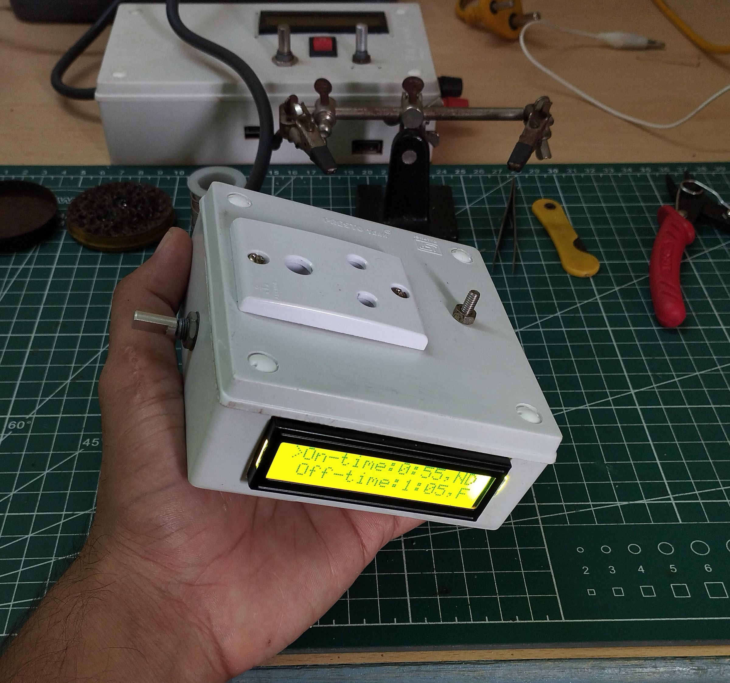

Step 6: Enclosure
For the enclosure, I used a 5 × 7-inch white PVC box, commonly used for electrical fittings. I made cutouts for the USB port, LCD screen, and an ON/OFF output switch, along with holes for the banana socket connectors, rotary encoder, and potentiometer. To keep the design compact, I also mounted the laptop adapter inside the case.
The most challenging part was fitting the LCD display, as its large size made placement difficult. I would highly recommend using a smaller OLED display, as it has a smaller footprint, better flexibility, and improved clarity.
