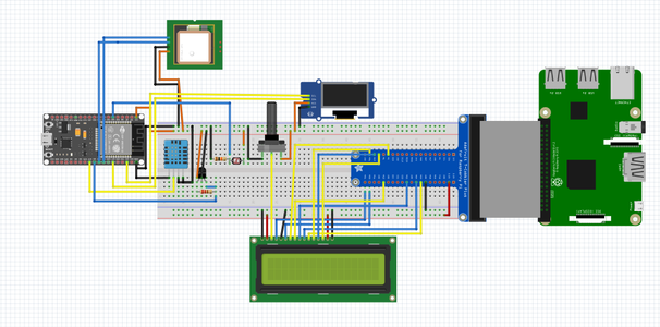

Step 1: Make the Circuit
this here is the circuit both the esp32 and the raspi. do note that you don't have to have these 2 together it's merely so you can see them both. you can connect everything directly to the raspi or have it on a breadboard just make sure you connect to the correct pins. (for the LCD check the class in the repository called LCD to make sure all the pins are correctly connected).
both of the resistors should be 10k Ohm.

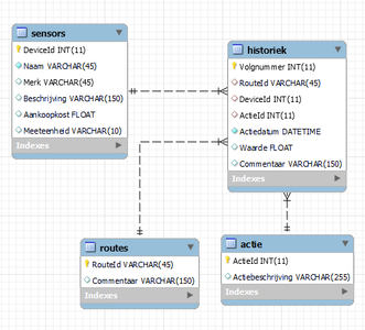

Step 2: Make the Database
When the app.py code is running you should be able to see if everything is working correctly and that the database is getting data. This would be whenever you first have the code running and are sending it data via the esp32. first things first make sure you have it on the side of the esp32 if so then check the app.py and then ofcourse your database.

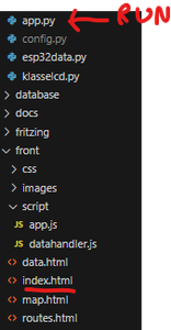

Step 3: Get the Code and Alter What's Needed
This here is what our code folder will look like.
the app.py is the file that should be running here.
it will catch the data from our esp32 so make sure your esp has the arduino code uploaded before anything else.

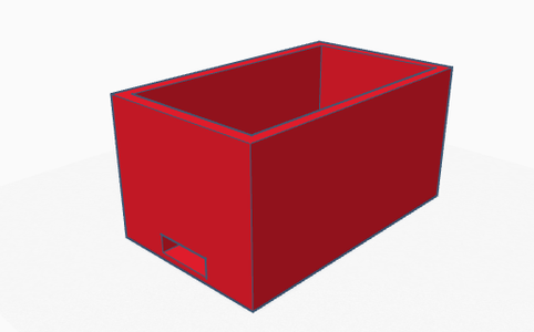

Step 4: Case
For my case that holds my esp and it's sensors I made a simple 3 print in which to hold it. here I make use of a small breadboard to keep it all in place.
As you might have seen in the final picture up top I ended up using the plastic of a U shape paper folder to cover the top with and put my lcd and ldr between.
Feel free to look for other case Ideas and or to make your own.
I'd actually suggest not using my 3d print as it ended up being a bit too small. You can keep the general same thing just make sure you have enough space for it all.

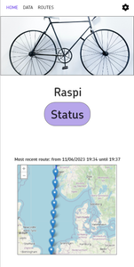

Step 5: Have Fun With It
try it out have some fun gathering data and displaying the various route's you do. If there's anything you'd like to add feel free to do so and if you've got any questions about my project feel free to contact me.
