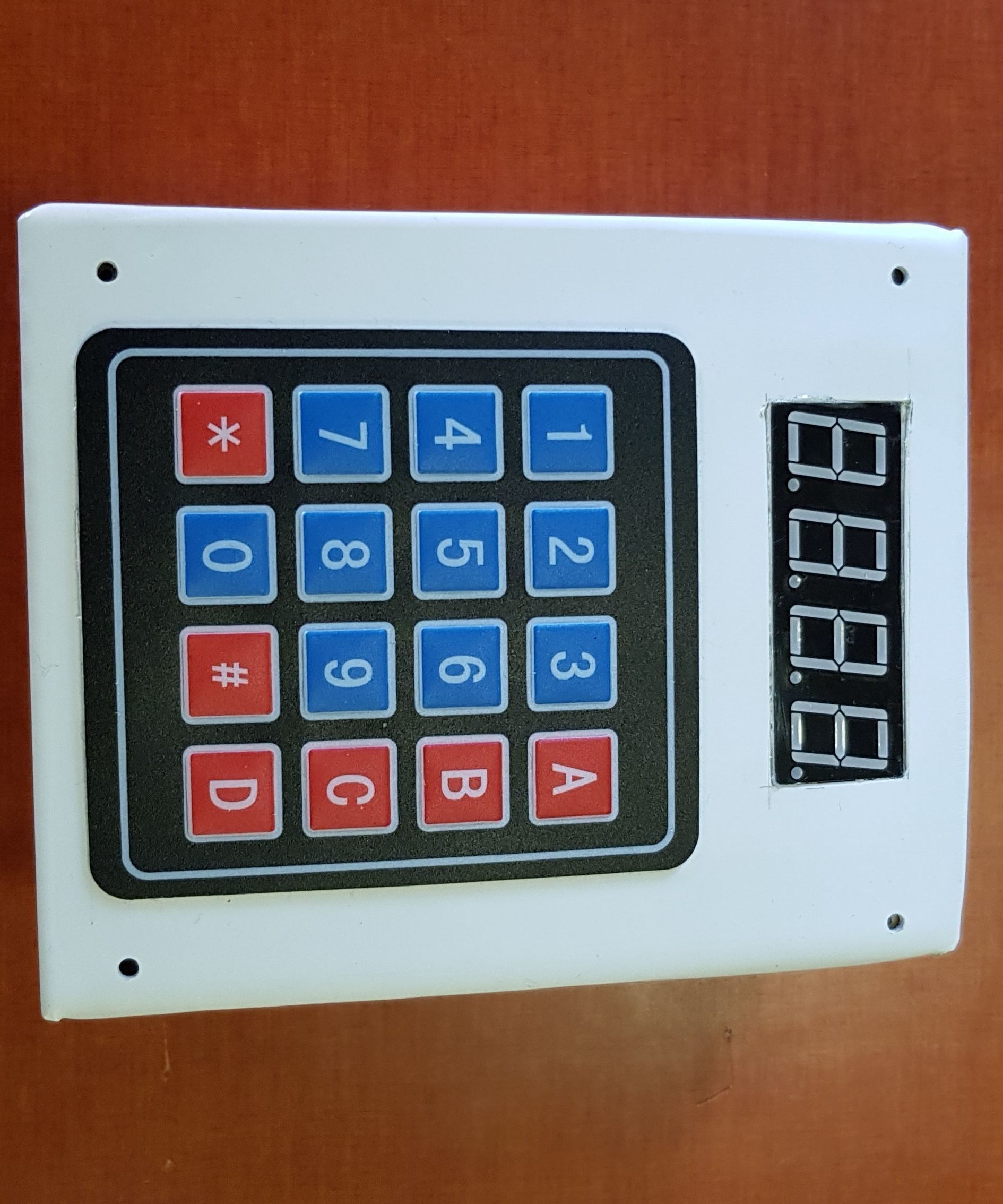

4 Digit 7 Segment Display
CLK -> Pin 7
DIO -> Pin 6
VVC -> 5V on Arduino
GND -> GND on Arduino
