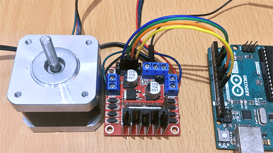

Step 2: Wiring Diagram
The wiring diagram thoroughly explains the operation of the system:
A 5V 2A power supply provides energy to the driver boards of the stepper motors that move the drive rollers (the two motors are connected in parallel via a breadboard);
An external 12V 3.5A power supply provides energy to the driver board of the stepper motor that moves the rack.
The two Arduinos share a common GND and are connected to each other via pins 8 and 12.
Note: We used two Arduino UNOs because we wanted to focus more on block programming rather than text-based coding. Unfortunately, the MBLOCK block programming software does not provide a dedicated extension for the Nema 17 motor, so we had to use the Arduino IDE with a dedicated library for this motor. We then connected the two Arduinos via a digital pin because after the conveyor belt moves, one Arduino sends a signal to the other Arduino to push the waste into the bin.
It is unlikely that 13-14-year-old students will be able to design a circuit like this independently. It is more feasible for the teacher to demonstrate the operational phases of the system and explain why two external power supplies are used and how the two Arduinos communicate with each other. The students can then follow the diagram to physically make the connections, paying close attention to the length of the jumpers and the securing of the various hardware components.
It is advisable to make some connections or cable extensions using soldering. This is an operation that, if supervised, students will greatly enjoy learning.

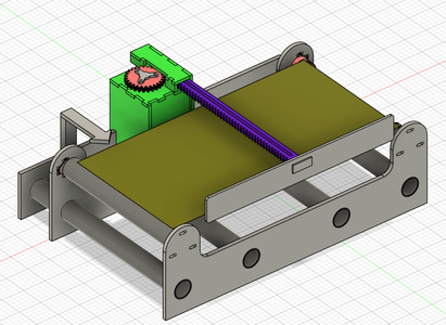

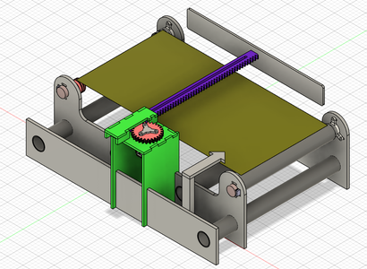

Step 3: Mechanical Structure
Please have your students try sketching rough ideas with pencil and paper of how they envision the supporting structure, once the project has been explained.
They should be able to draw the framework of the structure and gradually add details to each individual component (such as the movable rollers, approximate dimensions, etc.).
The 3D design, if it involves middle school students, is simpler if the teacher creates it using Fusion 360. In high schools, the preliminary 3D drawing can be done by the students, possibly using Tinkercad.
Students must still contribute to the initial design, hypothesizing the operating dynamics and the forces at play.
We have envisioned a structure that is not too large, allowing for the classification of three types of waste. The actual conveyor belt will be made of simple paper, both due to the low torque of the 28BYJ-48 steppers and because the idea is to reduce costs and, where possible, use recycled materials.
The supporting structure is designed to be portable and interlocking, making it easy to disassemble and construct using laser cutting.
There will be a tower dedicated to housing the Nema 17 motor, chosen for its good torque, considering that its pinion will be attached to a gear that needs to mesh with a rack (to convert rotary motion into linear motion), and the forces involved could increase; additionally, the stroke required to throw the waste into the bin is significant (about 30 cm). For the supporting structure, an 8 mm thick wood was selected, while for the supports of the Nema 17 and the containment of the rack, we chose wood with a thickness of 6 mm. For securing the two smaller stepper motors, which drive the conveyor belt, we planned for design-specific holes to ensure secure fastening.
struttura nastro

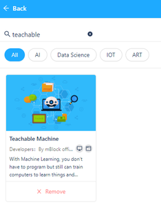

Note: Teachable Machine integrates perfectly within PICTOBLOX, another platform widely used for combining coding and AI in an educational context. However, in our case, we have decided to use MBLOCK (online versione) because we will need to relate SPRITES and HARDWARE, which, at the time of publishing this article, is not possible in PICTOBLOX.
As a result, we had to use the dedicated Machine Learning extension integrated within MBLOCK. The functionalities are limited and the results are less accurate, but for the type of project we are undertaking, it still works well.
We strongly recommend not taking photos directly within the application because, by doing so, the files are not saved locally, and in case of a malfunction, you could lose all your work. Instead, take the photos and save them on your computer, then upload them into the extension in MBLOCK.
By creating three classes of waste, they will be able to take multiple photos of the same object, ideally rotating it in all possible angles. We recommend carefully selecting the waste and photographing it in adequate lighting.
The extensions that can be used for this purpose are:
  1. Machine Learning 2.0
  2. Teachable Machine (the one we used).
The best approach would be to perform sampling directly from the webcam mounted on our system. If the system is not yet completed and you still want to conduct exercises with multiple computers, students can work in pairs using one computer, as previously mentioned.
