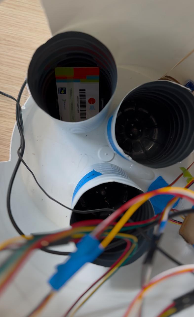

Step 2: Building the Hardware
  1. Prepare the plastic bucket:
  2. Cut a hole at the top to fit the recycled funnel
  3. Secure three inner bins evenly spaced inside the bucket
  4. Attach ultrasonic sensors:
  5. One for each bin, placed on top lid measure distance.
  6. Mount the LDR and IR sensor inside the funnel to detect material type
  7. Install the continuous servo motor:
  8. Attach the 3D printed washer to the servo motor shaft
  9. Connect the laser-cut gears to the funnel base
  10. Use laser-cut axles to support gear rotation
  11. Wire all components to Arduino UNO R4 WiFi:
  12. Follow basic sensor and servo pin mapping
  13. Use jumper wires and a soldered PCB
