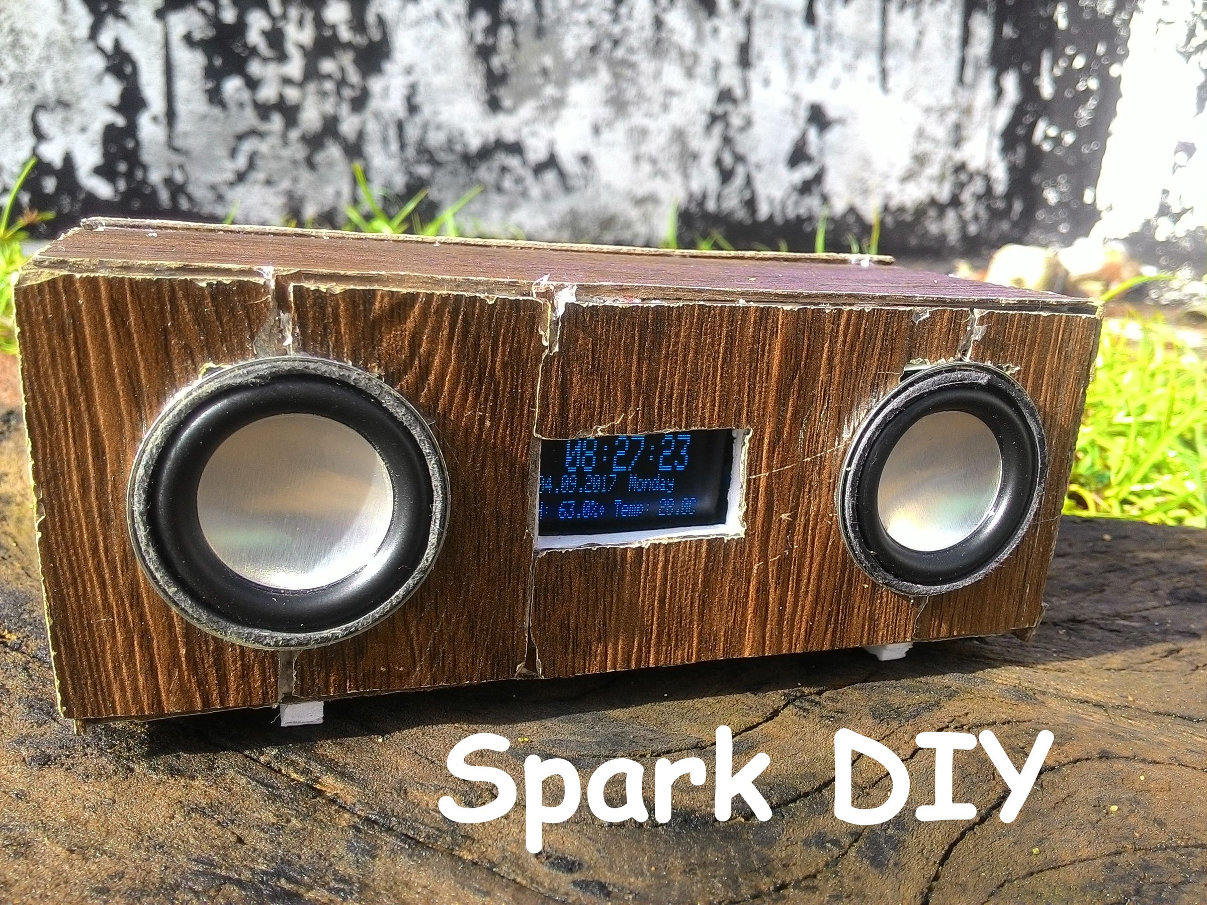

In this instructable, I would like to explain how to build a powerful smart Bluetooth speaker in a very simple way. The radios made a revolution in the 20th century every NEWS including war alerts were sent through the radio communication only. But the due to the use vacuum tubes during those days, size of radios were very big and most of them are packaged in a huge cuboidal box with 2 speakers. In this instructable, I've tried to give the retro look to my smart speaker. It has following features,
1. OLED display to show Date, Time, Day, Humidity & Temperature
2. Spectrum analyser to visualise the Music frequency Spectrum
3. Powerful sound output with around 10 hours of battery life
4. AUX input
5. TP4056 controlled charging unit
6. Bluetooth connectivity using F6188 Module
7. Hands-free mode to receive calls via Bluetooth
Features are cool, so let's make one...

The layout design is easy and you can design the way you want, I have attached my design plan which you can directly print it and paste it on material like foam sheet, cardboard sheet or plywood sheet etc. and directly you can cut it. The design attached has a dimension of 12cmx4cmx4cm. The speaker hole is dependent on your speaker dimensions. My speakers were 3cm in diameter so I made a hole using cutter knife and placed my speaker.

You can cut wood laminate plates in the same shapes and stick it over your speakers. This gives the retro or the 20th-century radio look.

Finally, we're ready to test our speaker. This speaker will work as a clock, a weather monitor and portable and powerful speakers.
