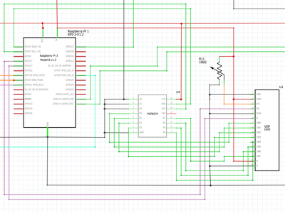

Step 3: Wiring the LCD
PCF8574 (I2C expander)
Just like on the datasheet the top of the PCF8574 is marked with a little notch.
Tip: Make sure that the I2C bus of your Pi is enabled
  • Connect A0, A1, A2 and GND to the ground
  • Connect VCC to the 3.3V of your power supply
  • Connect SDA to GPIO 2 / SDA1 I2C and SCL to GPIO3 / SCL1 I2C
LCD
  • Connect VSS, K and R/W to the ground
  • Connect VDD and A to the 5V side of your raspberry pi
  • Connect the potentiometer to 5V on one side and the ground on the other.
  • Connect the middle pin to the V0 of your LCD. This variable resistor can be used to adjust the contrast of the display.
  • Connect RS to GPIO 17
  • Connect E to GPIO 27
  • Now link all DB pins to the corresponding P pins on the PCF6574
(since we won't be reading anything from the display we might as well put it on the ground instead so it's always on write mode)

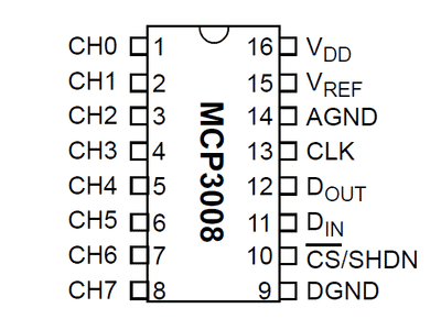

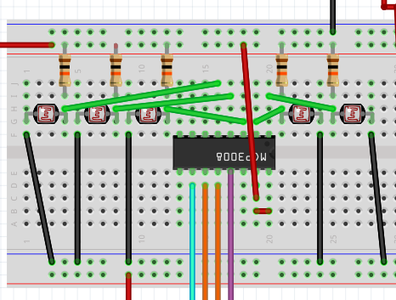

Step 4: Wiring the Light Sensors
MCP3008
Again the top of the chip is marked with a little notch.
  • Connect the Vdd and Vref pins to the 3.3V side of your raspberry pi
  • Connect AGND and DGND to the ground
  • Connect CLK to GPIO 11 / SPI0_SCLK
  • Connect Dout to GPIO 9 / SPI0_MISO and Din to GPIO 10 / SPI0_MOSI
  • Connect CS to GPIO 8 / SPI0_CE0_N
LDR
  • connect the 5 10kΩ resistors to the 3,3V of your raspberry pi
  • connect the other end of the resistors to the LDR and to a channel of the MCP3008 (from CH0 to CH4)
  • connect the other side of the LDR to the ground

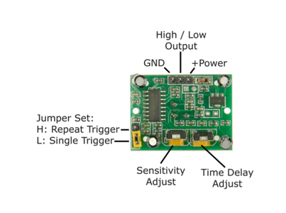

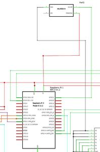

Step 5: Wiring the Infrared Sensor
I also included a picture with some extra information for this one because the normal one is a bit confusing.
  • connect the 5V power off your raspberry pi to the VSS (the right pin)
  • connect the middle pin to GPIO21 on your raspberry pi
  • connect the ground to the ground
I keep the jumper set to single trigger (the bottom one)
My sensitivity is adjusted in the middle and the time delay is turned almost completely to the right, but that is more a personal choice.

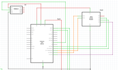

Step 6: Wiring the Arduino
WS2812B (led strip)
I used a led strip with less than 30 LEDs. If you are planning on using a bigger one then you will need to get an
external power supply for it.
  • Connect the 5V from the Arduino with the VSS of the LED strip
  • Connect the Din with D7 of your Arduino
  • Connect the ground to the ground of your Arduino
RFID-RC522
  • Connect the 3,3V from the RFID scanner with the 3,3V of the Arduino
  • Connect the RST with D9 PWM
  • Connect the MISO with D12
  • Connect the MOSI with D11
  • Connect the SCK with D13 SCK
  • Connect the SDA with D10 PWM
  • Connect the ground of the RFID reader to the ground of your Arduino
