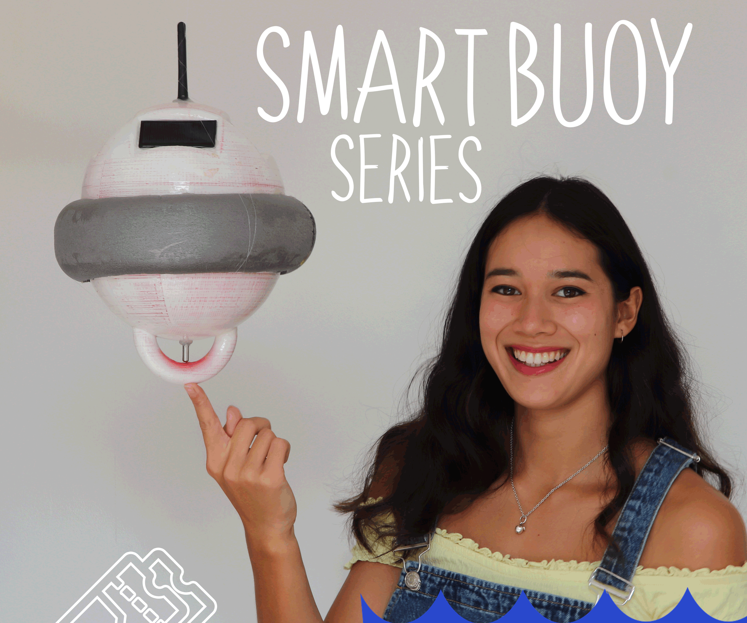

Step 2: Build - Buoy Casing
This Buoy was probably the most difficult thing we’ve printed so far. There were just so many things to take into consideration as it was going to be in the sea, exposed to the elements and a lot of sun. We will talk more about that later in the Smart Buoy series.
In brief: we printed a near hollow sphere in two halves. The top half has slots for the solar panels and a hole for a radio aerial to go through. The bottom half has a hole for a temperature sensor to go through and a handle for a rope to be tied to.
After printing the Buoy using PETG filament, we sanded it, spray painted it with some filler primer, and then put on a couple of layers of epoxy.
Once the prep of the shell was complete, we put all the electronics inside and then sealed the water temperature sensor, radio aerial and solar panels using a glue gun. Finally, we sealed the two halves with StixAll glue/adhesive (super aeroplane glue).
And then we hoped it was waterproof…

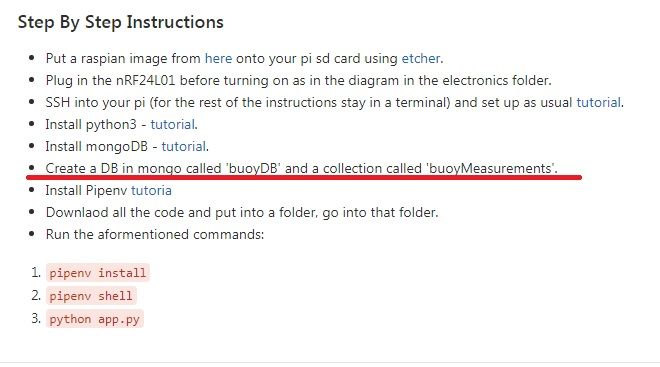

i am new to raspberry pi and vue js server kindly help by guiding me how to upload your files in raspberrypi and run the vue js server.
Reply 1 year ago
Hi we added some more instructions on the repo https://gitlab.com/t3chflicks/smart-buoy/tree/add_more_instructions_to_rpi/server
Reply 1 year ago
nice of you, i have gone through your instructions on the repo https://gitlab.com/t3chflicks/smart-buoy/tree/add_more_instructions_to_rpi/server.
its given "Create a DB in mongo called 'buoyDB' and a collection called 'buoyMeasurements' " .
but you have not instructed on How to create a DB and collections ?
