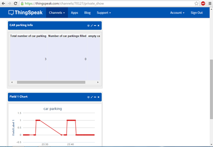

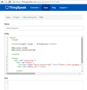

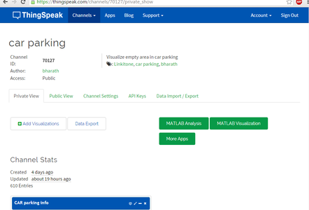

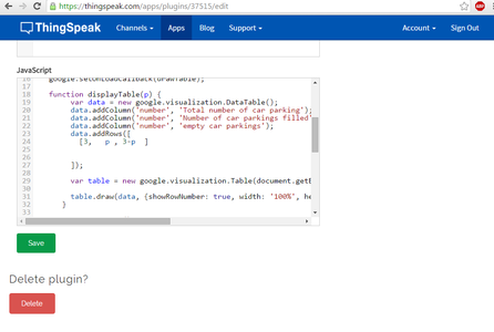

Create an account at ThingSpeak website (https://thingspeak.com/) and Create a Channel , add visualization of your own choice. I made a table using Javascript to display the car parking details...
Visualization javascript
You can add graph, gauge,etc to you channel...... Be sure to change the channel id in Visualization...
Now note your Write api key of your channel
