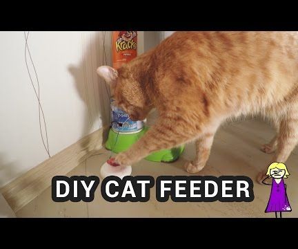

Introduction: Smart Cat Feeder
If you're tired of your cat screaming at you every morning you can build a cat feeder for it.

Step 8: Fill Up and Enjoy
Put some food or treats inside and enjoy your cat using it's own smart device!
