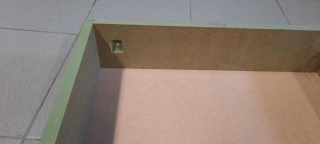

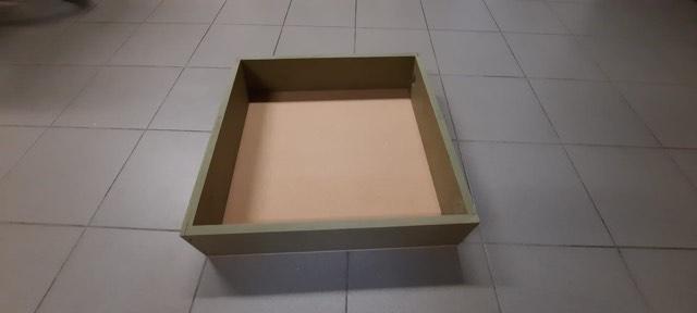

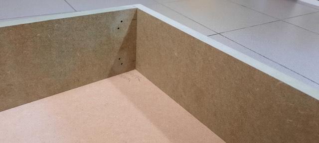

Step 1: Case
Take your MDF plates and cut them into the correct sizes.
Sides: 120mm x 610mm (18mm)
Bottom: 610mm x 610mm (18mm)
Top: 610mm x 610mm (9mm)
Screw The sides and bottom together. Other ways of holding the planks together is also fine, use what works best for you.
Drill holes in the sides for the potentiometer and buttons. The exact measurements are in the PDF file below.

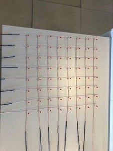

Step 2: LED Matrix
The schematic of the Led matrix is pretty straight forward. You have 16 wires in total, 8 rows and 8 columns. You should probably watch a video on how a led matrix works so you don't accidentally solder something wrong incase you don't already.
I folded the legs of my led's in advance so its easier when soldering. Place all the led's in the holes you drilled in the top so they stay in place and get to soldering.
This step isn't very hard it just takes up a lot of time so be prepared :)
I included the whole schematic below. Just look for the big led matrix if the image on top isn't clear.

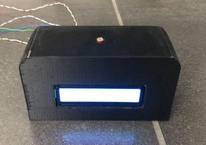

Step 5: Clock
As you know in almost every official chess game there is a clock to time each player independently. My version of this clock involves a single LDR for both players to use as a termination of their turn. The LCD is added to display the IP of the server the website will run on. This step is not mandatory but my 3D model does include a cutout for it.
I used a Ultimaker 3S to print my model but any 3D printer should work fine. The .STL and .IPT of my model are to be found below. If you do not have a 3D printer to your disposal you can invent something on your own :)

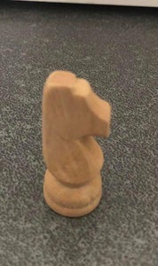

Step 6: Chess Pieces
In order for the reed switches to be able to sense when a piece is picked up and placed we will need to put magnets in to the chess pieces. When using the same thickness of MDF as the top I calculated that 3 10mm x 1mm stacked on top per piece are the right magnetic strength. Drill a hole in the middle of each piece of 10mm diameter and about 5mm deep.
Put a little hot glue in the hole and carefully place 3 magnets in there. Turn it facing up and let it dry. Do this for everyone of the 32 pieces.

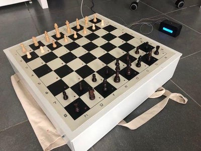

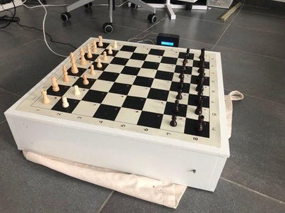

Step 7: Putting It All Together
In this last part you will connect everything together. Use breadboards or soldering to your liking. Follow the schematic closely as a single mistake can ruin the entire project.
After all the electronics are sorted out, tape the acrylic chessboard on top with double sided tape. Place the magnetic chess pieces on the board. Now you should be ready to upload the code and start playing.
