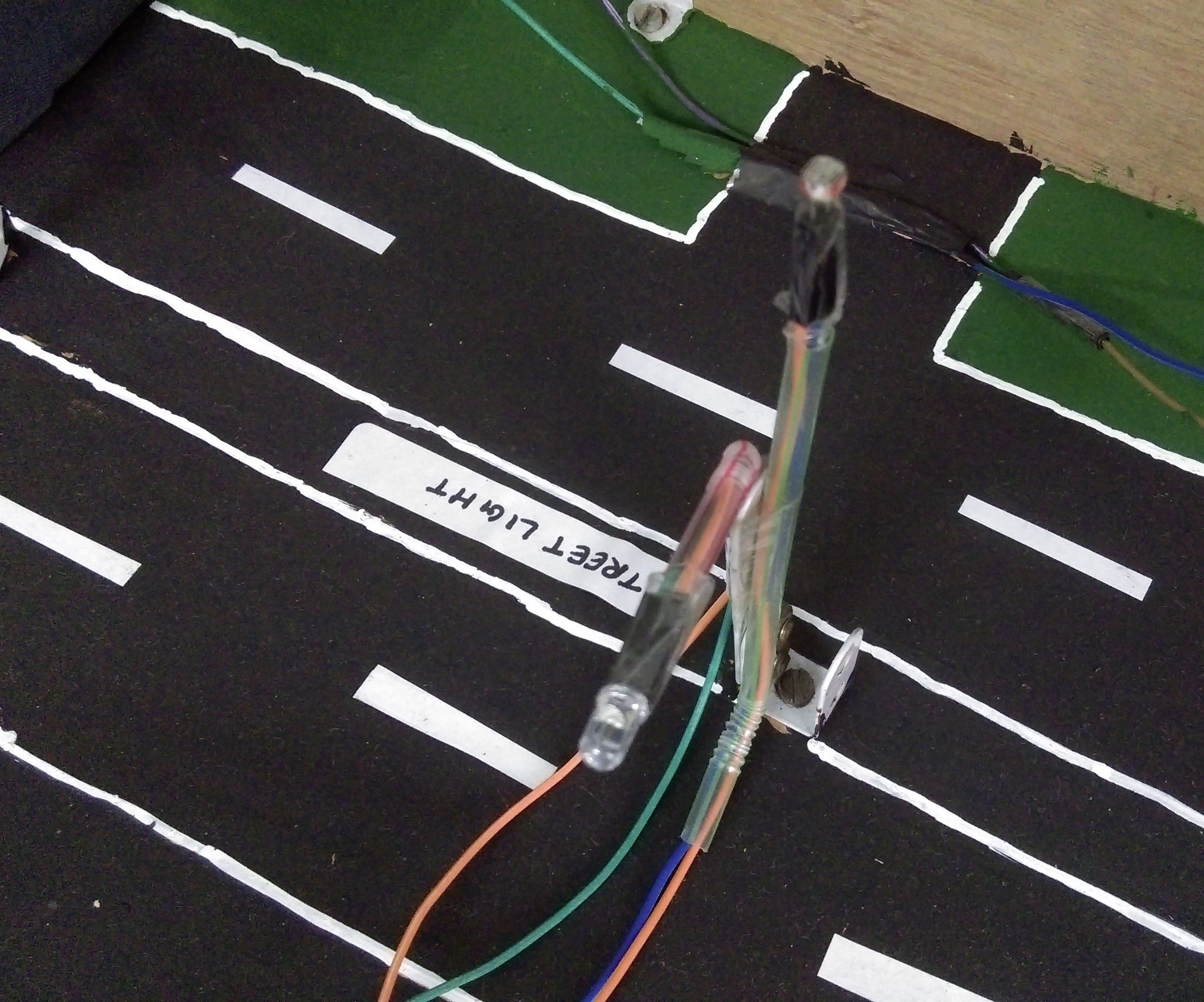

Streetlight System-
LDR- One end of LDR is connected along with one end of Resistor with an Arduino pin(pin A0). The other end of LDR as well as Resistor is given Ground.
LED- One end is connected to an Arduino Pin(pin 5) wheres other end is given Ground

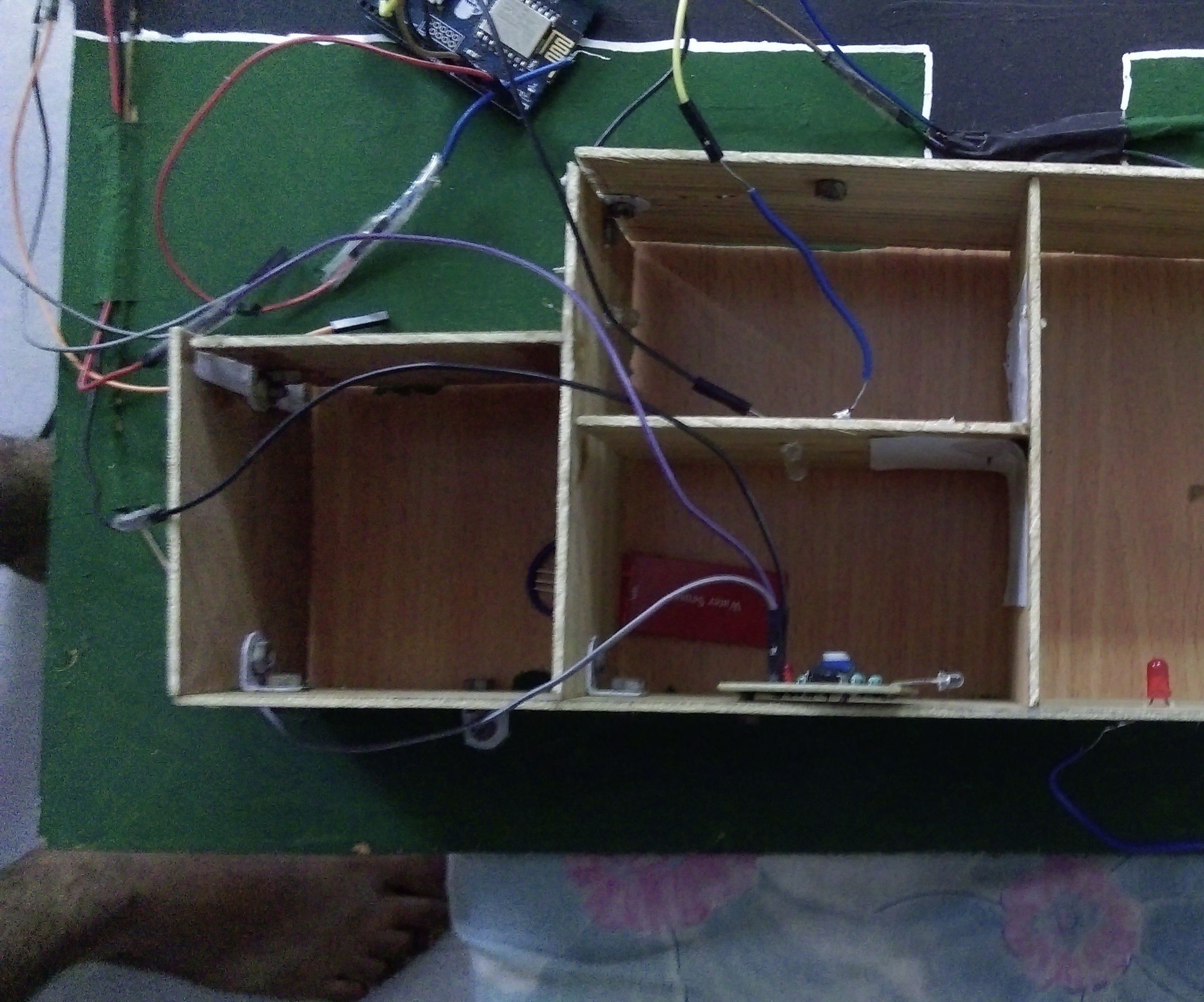

Energy Efficient Buildings-
Bolt Iot Platform is sa,e as Arduino Uno but with an attached functionality of connecting to a network
Bolt has 7 Digital Pins, Rx,Tx, 3 Analog pins and 2 Vcc and 2 gnd pins Connect +ve terminal or three LEDS with 3 pins(pins 0,1,2) and -ve terminals to GND Connect Bolt and your computer to the same wi-fi Network. for other configurations help access inventrom bolt website. upload the following code into the bolt. always save the code as index.htm bolt iot generates dynamic IP every time so check that ip using Fing Application and access that ip the current IP for my bolt is 192.168.1.66 access 192.168.1.66/developer to upload the program and then access 192.168.1.66/reset to reset the bolt .

Streetlight-
Int a=A0;// One terminal of LDR is connected to pin A0
Int B=5; // LED is connected to pin 5
Int p=0; //threshold value
void setup()
{ pinMode(a,INPUT);
pinMode(b,OUTPUT);
Serial.Begin(9600); }
void loop() {
p=analogRead(a);
If(p<20 )
{ digitalWrite(b,LOW);
} Else if (p>16) {
digitalWrite(b,HIGH); } }
<html>
<body>
<center>
<h3> Home Automation/ Energy Efficient Buildings </h3>
<h4> Room 1</h4>
<button><a href="http://digitalWrite?pin=0&state=HIGH"> LIGHTS ON </a></button>
<button><a href="http://digitalWrite?pin=0&state=LOW"> > LIGHTS OFF<a/></button>
</center>
</body></html>

Streetlight-
Working of this module is simple. LDR detects the amount of sunlight
(light in this case) falling on its surface. It converts it into an analog value which is fed into variable p. Now threshold value is set. If p is greater than 20, it means that sunlight is bright, so the LED shouldn’t glow. If the amount is less than 16, it would mean that the amount of sunlight falling on the surface is less (evening) so it would automatically glow up.
As soon as the user clicks on the button to turn the light on, and since the interface as well as the Bolt is connected in the same network, the bolt would generate the click of the user and produce the specified results.
this system can be easily implemented and a better interface could be built which would allow a user to easily control the electronics.
