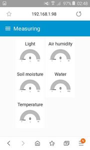

- display, in percentage, the amount of water available in the tank
- display of the temperature and humidity of the air received from the box
- display, in percentage, the humidity of the soil in which the plant is planted

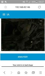

- detect the presence of the mint and signal its current state by saying if this mint plant is sick or healthy and this is thanks to a camera and an artificial intelligence program already integrated on Raspberry Pi3.
To better illustrate the concept of Internet of things there is a small portable box that has been designed. It allows to send remotely in real time and continuously the current value of air temperature, air humidity and soil moisture. In the same way this small box allows to inform us about the state of the plant thanks to the color of the led installed in the upper part:
- if the color of the led is red it means that the plant is hot.
- if the color of the led is blue it means that the plant is cold
- if the color of the led is green it means that the plant is thirsty

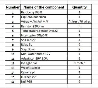

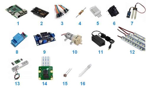

Step 2: Electronic Components
1- Raspeberry Pi3 B: it is a very small
computer with an ARM processor that allows the execution of several variants of the free GNU/Linux operating system, including Debian, and compatible software. This board has several models and i have used the Raspberry Pi 3 B model in this project to control the associated electronic components on the plant pot as well as to run the artificial intelligence program.
2- Esp8266 nodemcu : it is a microcontroller with a Wifi connection through which data can be sent and received remotely to Raspberry Pi3. i used this microcontroler to control the associated electronic components (Dht22 / Soil sensor / Led RGB)
3- Wires M/M F/F : Allow to conduct electricity to the desired location.
4- Resistances : are all of a value of 220ohm connected with some electronic components to prevent them from being burned.
5- Temperature sensor DHT22 : Senses the temperature degree that will be displayed automatically on the LCD display.
6- interruptor ON/OFF: Ideal for controlling the flow of electric current to all electronic components.
7- Soil sensor : is an analogical sensor designed to measure the volume of water present in the soil.
8- 5V Relay : to help the Raspberry Pi board to turn the mini water pumps on and off.
9- LM2596 DC-DC Module (Step Down) : it is an Adjustable Voltage Regulator Lowerer and thanks to which the Raspbery Pi board and the other components are powered from 19V.
10- mini water pump 12V : pump particularly suitable for the transfer of the liquid food industry like milk, edible oil, drinking water ... etc.
11- Adaptator 19V 3.4A : essential to power the entire electrical circuit of the plant pot
12- Led light bar : to generate artificial light for the plant. There are two colors of light: red and blue.
13- Weight sensor : to measure the weight of 3 kg maximum. This sensor is placed under the tank to know the current water quantity in liters.
14- Camera Pi : camera module compatible with the Raspberry Pi with which you can take photos and videos. This camera is essential to analyze the current state of the plant with the help of the artificial intelligence program
15- ldr light sensor: it detects the degree of brightness outside the house. It is thanks to this component that the outdoor leds will turn on when it is dark and turn off when it is light
16- led RGB : capable of lighting up in three types of color: red, blue and green

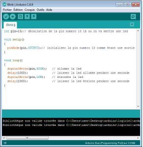

Once all the electronic components are properly connected to the ESP board, a computer program must be downloaded to ensure proper communication of the system. To create any program, we must first download the programming tool by consulting the following link: www.www.arduino.cc/en/Main/Software, then write the code in C or C++ language.

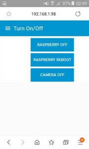

The proper functioning of this system requires also a good program to run on Nodered installed on Raspberry Pi3 B
Here is the arduino code source for who want to do the same

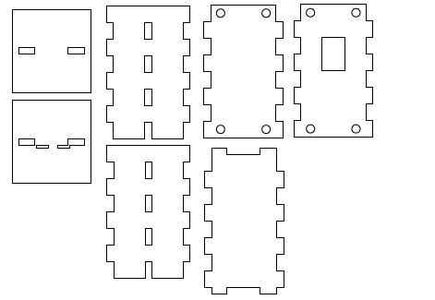

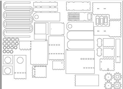

Step 5: Designing and Cutting the Model Using Solidworks and RDWorks
