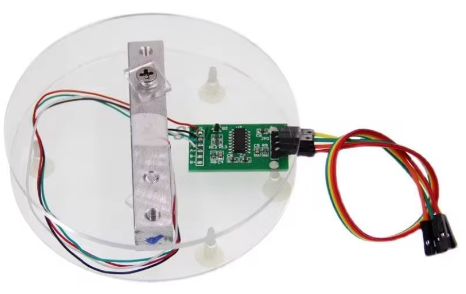

  3. One Weight Load Cell
  4. One HX711 ADC Sensor Module for Load Cells

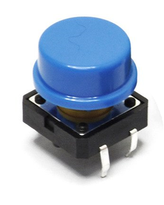

  7. Button

  1. Connect the Red wire from the Load Cell (Picture 1) to the E+ pin of the HX711 module
  2. Connect the Black wire from the Load Cell (Picture 1) to the E- pin of the HX711 module
  3. Connect the White wire from the Load Cell (Picture 1) to the A- pin of the HX711 module
  4. Connect the Green wire from the Load Cell (Picture 1) to the A+ pin of the HX711 module
  1. Connect HX711 ADC Sensor Module Ground wire(Black wire) to Ground pin of the Arduino board
  2. Connect HX711 ADC Sensor Module Power wire(Red wire) to 5V pin of the Arduino board
  3. Connect HX711 ADC Sensor Module  DT wire(Green wire) to Digital pin 3 of the Arduino Nano board
  4. Connect HX711 ADC Sensor Module  SCK wire(Yellow wire) to Digital pin 2 of the Arduino Nano board

  1. Connect Arduino Digital pin [4] to button on the breadboard and to the Resistor
  2. Connect other side of the resistor to the breadboard pin [GND]
  3. Connect Other pin of the button to the breadboard positive pin [5V]

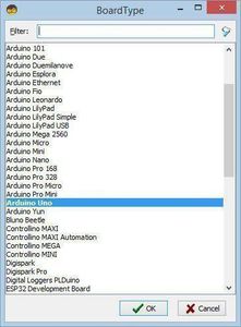

Step 4: Start Visuino, and Select the Arduino Board Type
Start Visuino as shown in the first picture Click on the "Tools" button on the Arduino component (Picture 1) in Visuino When the dialog appears, select "Arduino UNO" as shown on Picture 2

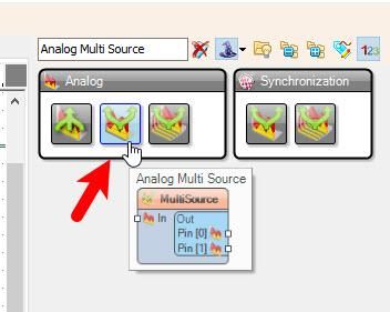

  3. Add 2X "Analog Multi Source" component

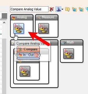

  4. Add "Compare Analog Value" component

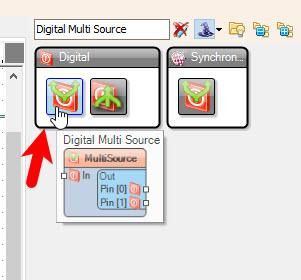

  5. Add "Digital Multi Source" component

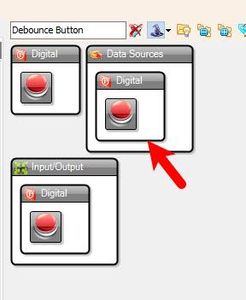

  7. Add "Debounce Button" component

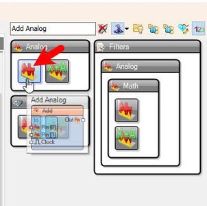

  9. Add "Add Analog" component

  1. Select "Compare1" component and in the properties window set "Compare Type" to ctBiggerOrEqual

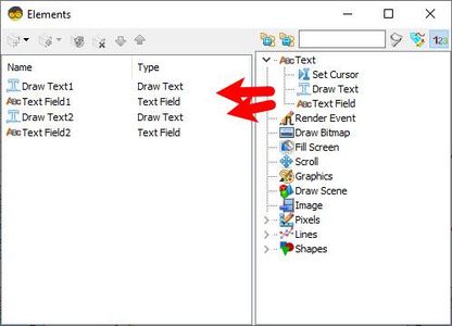

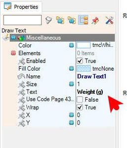

  3. Double click on the "DisplayOLED1" and in the "Elements" window drag "Draw Text" to the left side and in the "Properties" window set "Size" to 1 and "Text" to "Weight (g)"

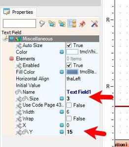

  4. In the "Elements" window drag "Text Field" to the lefty side and in the "Properties" window set "Size" to 3 and "Y" to 15

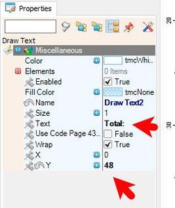

  5. in the "Elements" window drag "Draw Text" to the left side and in the "Properties" window set "Size" to 1 and "Text" to "Total:" and "Y" to 48

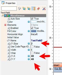

  6. In the "Elements" window drag "Text Field" to the lefty side and in the "Properties" window set "Size" to 2 and "Y" to 48 and "X" to 40
  7. Close the "Elements" window

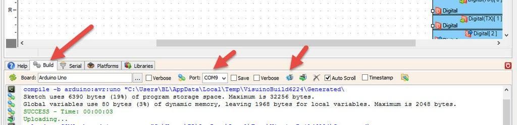

Step 7: Generate, Compile, and Upload the Arduino Code
In Visuino, at the bottom click on the "Build" Tab, make sure the correct port is selected, then click on the "Compile/Build and Upload" button.
