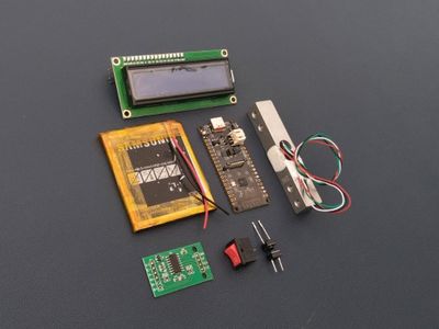

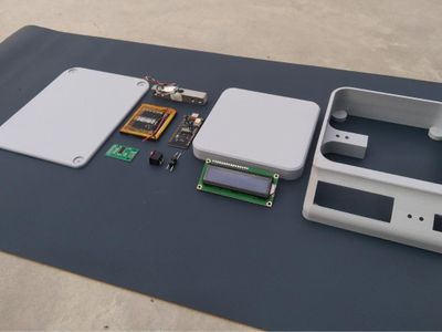

Components
  1. DFRobot Firebettle 2
  2. 20kg Load Cell
  3. HX711 Sensor
  4. 2*Push Switch
  5. On/off Switch
  6. 1602 LCD Display
  7. Lithium Battery (I'm using old smartphone Battery)
  8. 26 awg Silicon wire
Tools
  1. TS80P Soldering Iron
  2. Helping Hands
  3. Soldering Wire

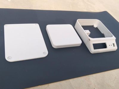

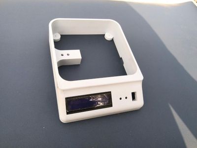

Step 1: CAD & 3D Printing
To begin, I designed this diy digital weight scale case using Fusion 360. You can view the design directly in your browser and download it to open in Fusion 360 for any modifications or creative additions. Feel free to customize and enhance the design as you like!
For 3D printing, you can directly download the STL files listed below:
  1. 1x Base.stl
  2. 1x Pan.stl
  3. 1x Bottom Cover.stl
For the 3D printed parts of this project, I used JLC3DP 3D printing service, which is gaining popularity for its high precision, wide material selection, and affordable pricing. They offer industrial-grade printing technologies like SLA, SLS, MJF, and FDM, delivering smooth, accurate, and durable parts suitable for both prototypes and final products. One of the best things about JLC3DP is their fast turnaround time and reliable global shipping, making it easy to get quality parts quickly. Whether you're a hobbyist or a professional, their platform is super convenient. Overall, JLC3DP offers a reliable and budget-friendly solution for anyone working on 3D printed projects. Use this link to get a huge discount on your order.

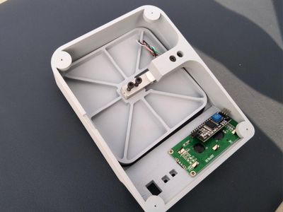

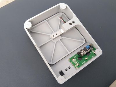

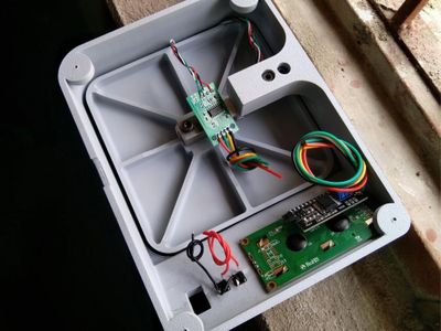

Step 2: Display Assembly

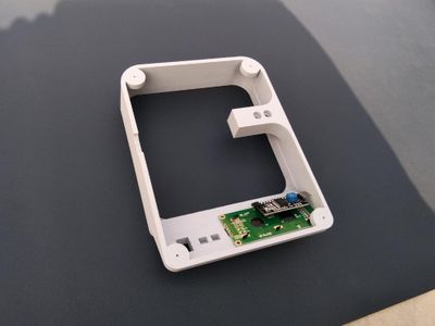

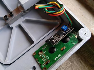

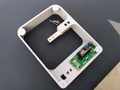

First place the 1602 lcd display to its slot, be careful while placing the display on its slot, make sure your putting a little bit of force, so that I can fit on it's slot.
Now Connect four wire to display, I used 26 awg Silicon wire for better results.
  1. Red (VCC)
  2. Black (GND)
  3. Yellow (SCL)
  4. Green (SDA)
Step 3: Load Cell Assembly

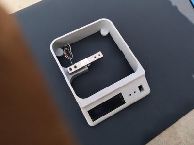

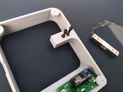

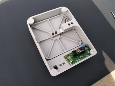

Now let's assemble the load cell on case, first use two M3 Screw to Mount it on bottom case. Use a Allen key to screw the M3 Screws. Now place the pan on top and use two more M3 Screw to screw it tight. Make sure everything is tightly screwed. Also make sure that you have screwed the load cell on its right side and angle. There will be a sticker on load cell, which indicates it's position.

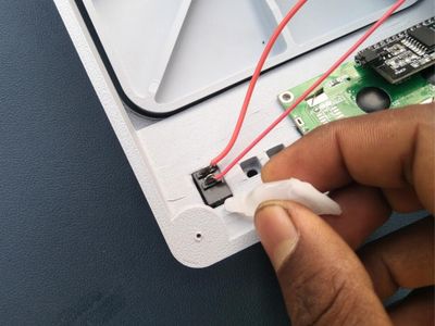

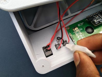

Step 4: Switch Assembly
Now place the switch on its slot, there're two types of switches. One is on/off Switch and 2 pcs push switch. Place the switch on its slot at one by one. Use a little bit of super glue to fix it on its slot.

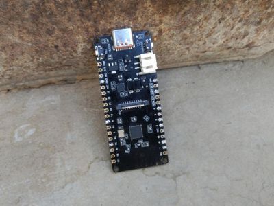

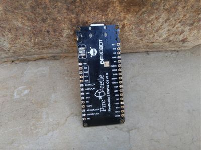

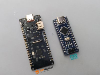

Step 5: Microcontroller Selection
To control this project, you need a Microcontroller, it works like a brain of this project. You can even use an Arduino Nano, but here I'm using DFRobot firebettle 2 esp32c6 because it's faster than Arduino Nano and it has a on board lithium battery charging Chip. So I don't need to add an extra charging module to charge the battery. Making it perfect for this diy project.

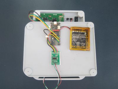

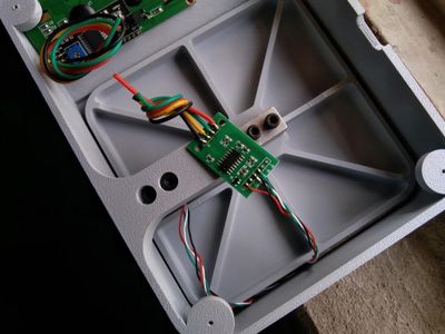

Now let's do the connection of all components. Since I haven't a laptop so that I can draw a schematic in fritzing to show you. Here I'll try my best to let you know everything about connection. Here's the connection between load cell and HX711 Sensor.
  1. Load Cell (Red Wire) TO HX711 (E+)
  2. Load Cell (Black Wire) TO HX711 (E-)
  3. Load Cell (Green Wire) TO HX711 (A-)
  4. Load Cell (White Wire) TO HX711 (A+)
Here's the connection between HX711 Sensor and DFRobot firebettle 2 ESP32C6.
  1. HX711 (VCC) TO Firebettle 2 ESP32C6 (VCC or 3.3v or 5v)
  2. HX711 (GND) TO Firebettle 2 ESP32C6 (GND)
  3. HX711 (DT) TO Firebettle 2 ESP32C6 (GPIO 2)
  4. HX711 (SCK) TO Firebettle 2 ESP32C6 (GPIO 3)
Here's the connection between LCD 1602 Display and DFRobot firebettle 2 ESP32C6.
  1. 1602 LCD (VCC) TO Firebettle 2 ESP32C6 (VCC or 3.3v or 5v)
  2. 1602 LCD (GND) TO Firebettle 2 ESP32C6 (GND)
  3. 1602 LCD (SCL) TO Firebettle 2 ESP32C6 (GPIO 7)
  4. 1602 LCD (SDA) TO Firebettle 2 ESP32C6 (GPIO 6)
Here's the connection between push switch and DFRobot firebettle 2 ESP32C6.
  1. Connection of first switch, which is a calibration button.
  2. One Side of Switch TO Firebettle 2 ESP32C6 (GPIO 4)
  3. Second Side of Switch TO Firebettle 2 ESP32C6 (GND)
  4. Connection of Second switch, which is for Tare Function.
  5. One Side of Switch TO Firebettle 2 ESP32C6 (GPIO 5)
  6. Second Side of Switch TO Firebettle 2 ESP32C6 (GND)
Connection of battery with microcontroller is very simple, just connect the battery to the microcontroller, there're already two polarity marked on it plus and minus. Plus for positive and black for negative. Also a connection of on/off Switch is simple, just connect it between the power output and you're done!

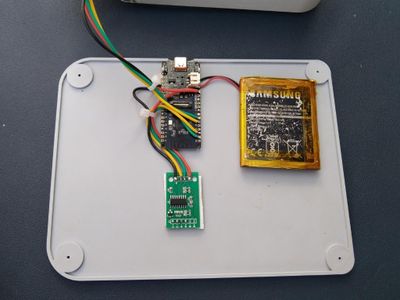

Step 7: Rest Components Assembly

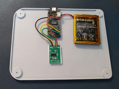

Now only few components are left to assemble, Since there's no dedicated space for the HX711 sensor and microcontroller & lithium battery, a simple trick works best! Just add a small piece of double-sided tape to the bottom panel and firmly place both components on it. This keeps them secure without any extra hassles.

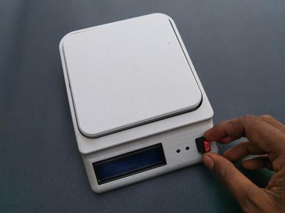

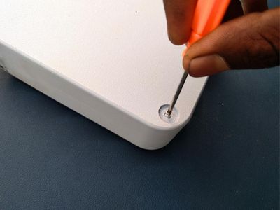

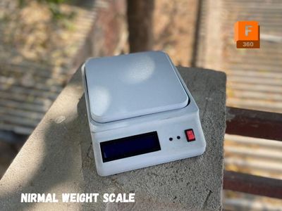

Step 8: Final Assembly
Now that everything is in place, it’s time for the final touch! Align the back panel carefully and secure it using screws. Make sure everything fits snugly, and don’t overtighten the screws. Once done, give it a quick check to ensure everything is secure. You can use a rubber pads for more attractive looking and long term use.

Before using the DIY Nirmal Weight Scale, it's important to fully charge the battery. Since I used DFRobot firebettle 2 ESP32C6, it has a on board lithium battery charging Chip. allowing for convenient and efficient charging. Simply connect it to a power source via the built-in charging port, and once the battery is charged, the green led on microcontroller will be glow & the scale will be ready for use.

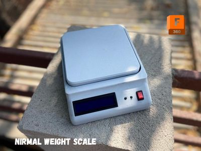

During testing, the scale performed exceptionally well, providing accurate and consistent weight measurements. It successfully handled various kitchen ingredients, ensuring precision for cooking and baking. The display was clear and easy to read, and the overall response time was quick and reliable.
This thorough testing process confirms that the Nirmal Weight Scale is not only functional but also a dependable kitchen tool for everyday use.
