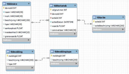

Step 3: Database
All the data collected by my project will be saved in a SQL database with some relational tables.
You will need to import the database into your MariaDB installation on the Raspberry Pi, in order to do this, you can download the database dump to your computer. After that, you can open MySQLWorkbench and create a remote connection to the database server on the Raspberry Pi. Finally, you can open this connection and click 'Data Import/Restore' under 'Administration' in the left column to import the provided .SQL file.
