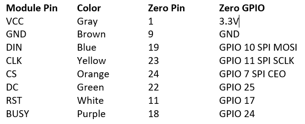

Step 3: Install E-Paper Screen
The screen should arrive with a wired plug. Properly orient the plug and carefully but forcefully plug it in to the module. Attach the module wires to the Zero pins listed above. The wire colors may be subject to change, so always match the label on the module to the corresponding Zero connection.
