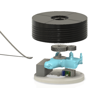

For safety reasons and to be able to save power, I want to be able to periodically disconnect any power from the system when the lamp is not in use simply by using the wall light switch. This means that the winder must not unwind as soon as the motor runs out of power. Conceivable would be to use a complicated braking system that holds the cable drum without power. But since the motor has to reach a relatively high torque anyway and a gearbox is needed for this, I thought why not use a motor with a worm gear, which is self-locking. The internet search for motor and worm gear turned out to be difficult. Very high prices or very long delivery times.
Since I wanted to implement the project quickly, I thought about where such motors are used and came to the idea on Ebay-Kleinanzeigen (the German Craigslist) to look for car window motors and was found for 5 € in my neighborhood.
To be able to plan the construction further in Fusion 360 I needed a 3D model of the motor. Unfortunately I didn't find anything on the internet, so I created a photogrammetry with Meshroom (https://alicevision.org/) and took about 100 pictures with my cell phone. I was then able to import this into Fusion 360 as an STL file and scale it correctly with a caliper.
To make it look tidy under the ceiling, I want the cable drum to move around all the other components. It should remain as small as possible for optical reasons and for dynamic reasons. Here is a short calculation .
mass lamp m_lamp ~= 5,0 Kg
radius of drum ~= 0,12 m
necessary driving torque ~= 5,0 Kg* 9,81m/s^2 *0,12m ~=5,9 Nm
So if my lamp weighs about 5 Kg and the radius of the cable drum would be 12cm, I would already need a drive torque of almost 6 Nm, which would be quite a lot. If I would make the radius of the drum even larger, the required drive torque would also increase.
So it would be best if the output of the motor was centered on the motor. To achieve this, I had to add another gear ratio made from 3D-printed gears, and weld a new gear axle to the metal housing of the motor. The area where the old electronics of the window motor was installed I could cleverly use for the new electronics.
So that the two lamp cables do not twist when turning the cable drum, a slip ring had to be installed in the cable drum. I removed this slip ring from the cable drum of a defective vacuum cleaner, took the dimensions and constructed suitable grooves in the output gear wheel.
