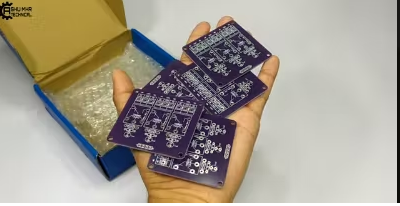

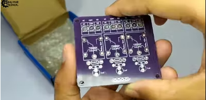

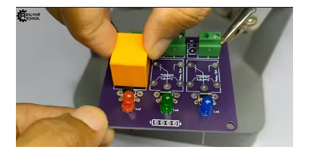

Step 2: Get Your PCB Ready
Talking about electronics
  • After making the circuit diagram I transformed it into a PCB design to produce it, to produce the PCB, I have chosen JCLPCB the best PCB supplier and the cheapest PCB provider to order my circuit. with the reliable platform, all I need to do is some simple clicks to upload the Gerber file and set some parameters like the PCB thickness color and quantity. I’ve paid just 2 Dollars to get my PCB after five days only, what I have noticed about JCLPCB this time is the "out-of-charge PCB color" which means you will pay only 2 USD for any PCB color you choose.
Related Download Files
As you can see in the pictures above the PCB is very well manufactured and I’ve got the same PCB design that we’ve made for our main board and all the labels and logos are there to guide me during the soldering steps. You can also download the Gerber file for this circuit from the download link below in case you want to place an order for the same circuit design.

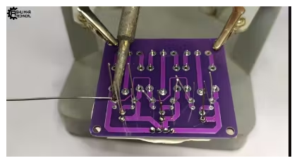

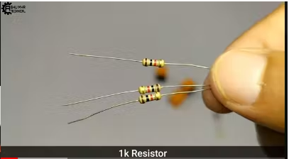

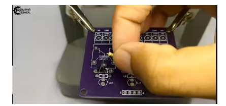

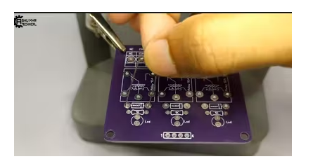

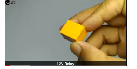

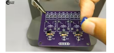

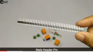

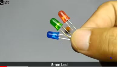

Step 3: Place All the Components on the PCB and Soldier It Properly

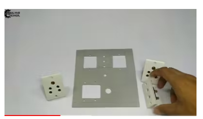

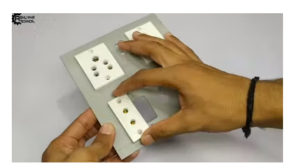

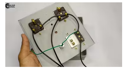

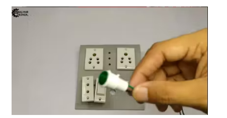

Step 4: Now, We Will Make a Electric Board

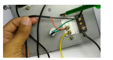

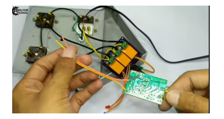

Step 5: We Will Connect All These Sockets to Each Other.
  • We will take one point common from each socket whose input will be connected to main power supply.
  • And, We will connect one-one wire to empty point of each socket which will connect to our Relay module.
  • A power supply wire will be connected to one point of switch.

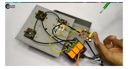

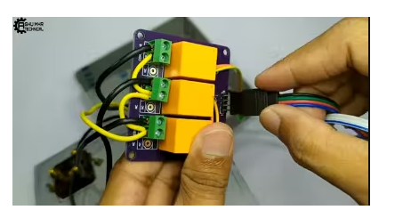

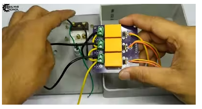

Step 6: Now, We Will Connect Our Module to the Board.
  • We will take one point common in our module same as we have done in extension board.
  • In second point, we will connect our extra wires that we have drawn out from the extension board.
  • And the common wire will connect to one of the point of switch.
  • We will connect one wire of main supply to common point of socket and second wire to empty point of switch.

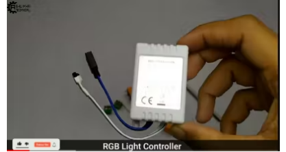

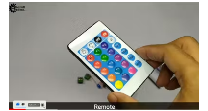

  • Now, We will connect our RGB controller to module and we will use 12 volt adaptor (circuit) for power supply.
  • We will connect this circuit to the main supply.

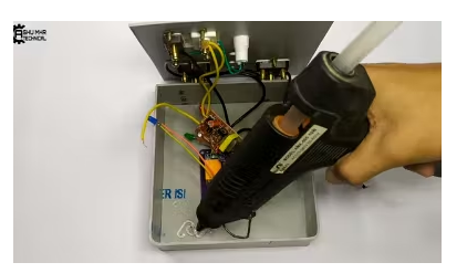

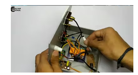

Step 7: Stick the Circuit to Your Custom Designed Box With the Help of Glue Gun.
Step 8: Cover the Box and Place All the Components of PCB on Their Respective Holes or Places.
Now your own  Smart Electric Board  is ready to use.

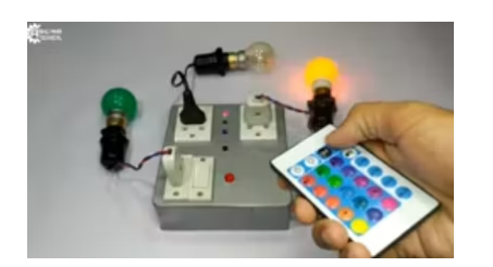

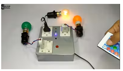

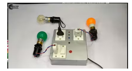

Step 9: Testing :-
For testing purpose I am using 220 watt bulbs of different colors. As you can see below in the images that we can operate our board with the use of our remote. Our Smart Electric Board works well. Now, we can attach it with our prototype.
