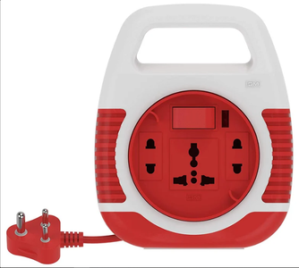

  8. A 3-pin power cable (As shown in the image. It is normally used to connect a home PC. The end connecting to the SMPS needs to be cut and wire has to be split to expose the three wires). I selected this wire as it can withstand the slightly heavy loads we use for testing out projects. Please identify the phase/line (Red), neutral (Black) and earth (Green) wires and properly connect them. Readers can choose the best one. It is not mandatory to use the cable shown in the image.

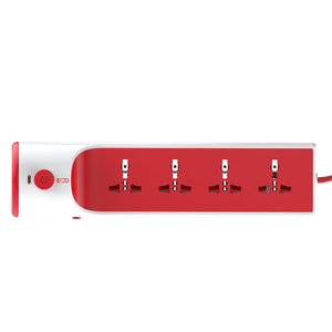

  9. A 4-Pin Socket Spike Suppressor. This will help us connect the Microcontroller, and to power PZEM004T-V3 Sensor.
  10. A 3-pin socket is optional, but it will help us connect a load and check the values on the dashboard.

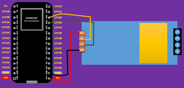

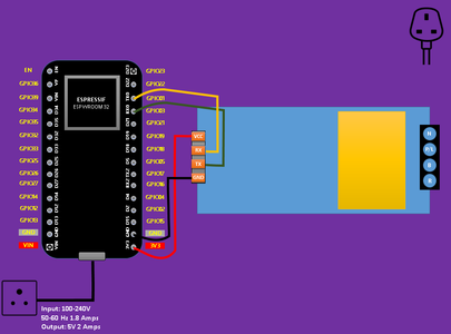

  1. Following will be the connections between ESP32 and PZEM004TV3
  2. VCC pin of PZEM004TV3 to 3V3 pin of ESP32 (Indicated in Red)
  3. GND pin of PZEM004TV3 to GND pin of ESP32 (Indicated in Black)
  4. TX pin of PZEM004TV3 to RX pin of ESP32 (Indicated in Green)
  5. RX pin of PZEM004TV3 to TX pin of ESP32 (Indicated in Orange)

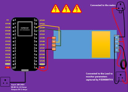

  6. Connect ESP32 to the suggested power adaptor. I used power adaptor with specifications: "Input: 100-240V; 50-60 Hz 1.8 Amps; Output: 5V 2 Amps"
  7. Connect PZEM004TV3 to the three-pin plug, socket, and the current transformer (CT) as shown in the picture.
After you are done with all the above steps, connect the three-pin plug to the mains and move to the next section.

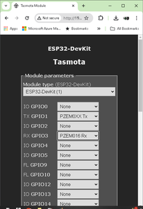

Step 3: Configuration Changes in Tasmota
The following steps will help readers successfully configure and observe the energy parameters.

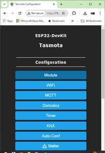

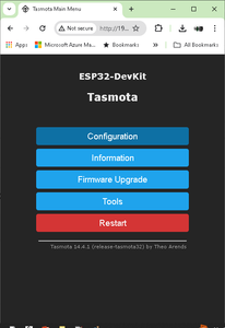

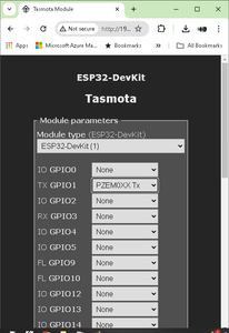

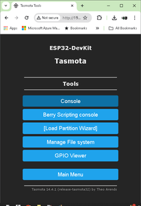

  1. Access the Web page with the IP address assigned to your ESP32 (192.168.29.195 in my case)

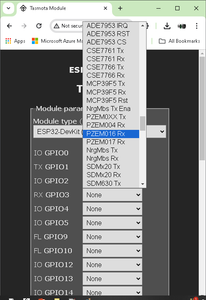

  2. Hit on "Configuration", then on "Module".

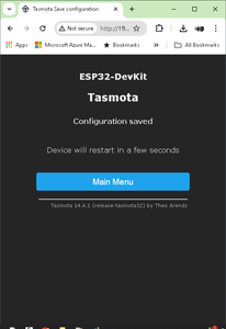

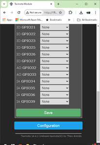

  3. On the next screen, select "PZEM0XX TX" from the dropdown list of "TX GPIO1", and select "PZEM016 RX" from the dropdown list of "RX GPIO3". Navigate to the bottom of the web page and hit on "Save".
  4. Tasmota will restart the ESP32 to apply the changes to the configuration.

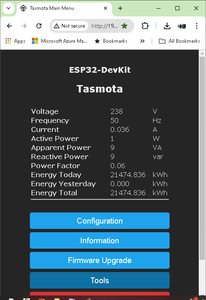

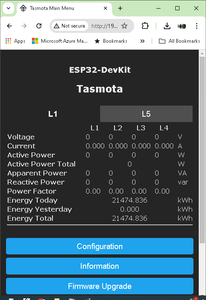

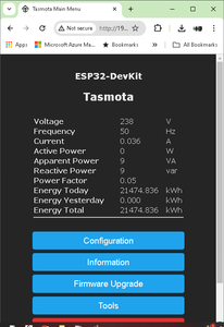

  5. Please allow some time for "Tasmota" to settle and fetch all the energy parameters you need.

I have observed some junk values appear in the dashboard. I will try to address them and post another article when I have a fix. In my next article, I wish to discuss Message Queue Telemetry Transport (MQTT) and the transfer of data for further analysis.
