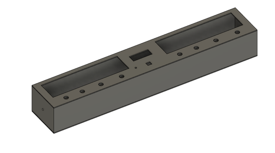

Step 3: 3D Designing
I based my case on the picture above. In the middle is a rectangle for an LCD display. Below that is a 10A fuse to fuse the sockets. The temperature sensor will be placed against the fuse. The round holes will hold the 8 pushbuttons. The two large rectangles contain a flush-mounting box for 4 sockets. These flush-mounting boxes will each contain 4 sockets. On the left-hand side, a round hole is made for the power cable.

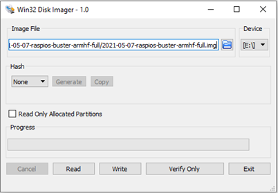

Installing Raspberry Pi OS:
Download Raspberry Pi OS: https://www.raspberrypi.org/software/operating-sys... .
I have downloaded the following Raspberry Pi OS: "Raspberry Pi OS with desktop and recommended software". Once this is downloaded you can unzip this zip file with Winzip or another program. Then I installed the Raspberry Pi OS Image on a SD card. I did this by using Win32DiskImager.

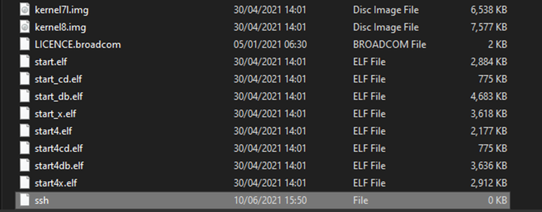

When this process is done you can open the file 'cmdline.txt' with your favourite text editor. At the end of the file add "ip=169.254.10.1". Keep in mind that everything has to be on one line and that there can't be any spaces at the '=' sign. After you have done this you can save the file and close it. Next, create a new text file called 'ssh' on the SD card. This will normally be a text file so you have to delete the '.txt'.

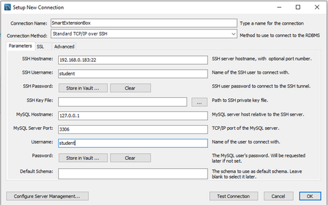

Connecting MySQL to MariaDB:
To make a communication between MySQL and MariaDB we need MySQLWorkbench. When MySQLWorkbench is started create a new connection.
The connection method is "Standard TCP/IP over SSH". If something is not clear you can always find more information on this site. When this is done you can reboot the Raspberry Pi by executing the following command:
sudo reboot now

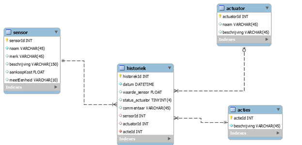

Step 5: Database Design
This plug-in block has a lot of information that needs to be stored. Firstly, the data of the 3 sensors is retrieved approximately every 15 seconds and stored in the Database. The status of the actuators is also logged in the history. Then, actions such as Temperature measured, Socket On, Socket Off, .... are added to this history.
You can find my database in my github repository.
