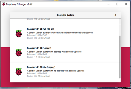

I used a 16GB SD card and inserted the card to my HP laptop. You can download the Raspberry Pi Imager from here Until the issues are clear with the new Raspberry Image, I'm using the legacy version.

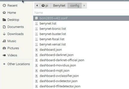

git clone https://github.com/DT42/BerryNet.git cd BerryNet ./configure

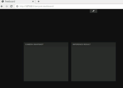

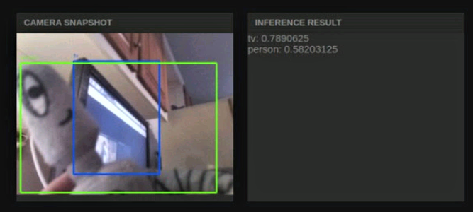

Open the Web Browser in Raspberry Pi and enter this address: http://127.0.0.1/berrynet-dashboard. Select Load Freeboard. Scroll down and select dashboard-tfitedector.json. You should see the camera snapshot and the Inference Result (best guess at what the camera is seeing)
