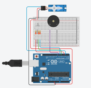

Step 4: Build the Arduino Circuit
Servo Motor - D2
RGB LED - Red → D3 Green → D5 Blue → D6
Piezo Buzzer - D7
