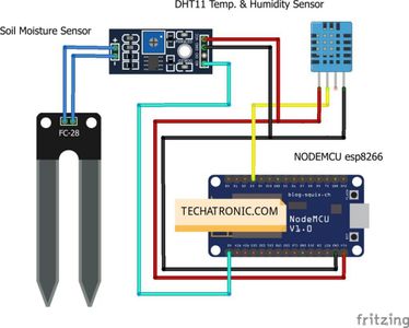

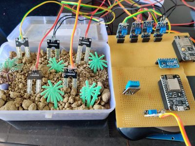

Hello friends, I'm back with another interesting project which is this time based on IoT. Today we're going to make a Smart farming Project using NodeMCU. In this project, we'll use very basic modules like Soil-Moisture Sensor, ADC, DHT11. These are easily available in the market for cheap also can be purchased online.

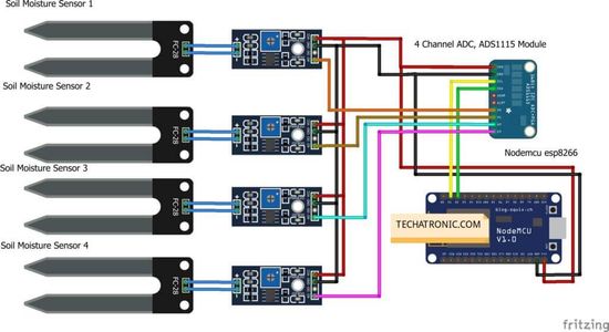

Here we are going to use two NodeMCU, because we have here 5 analog sensors and 1 DHT11. So we will use 4 soil moisture sensors with the Nodemcu 1 and dht11 and 1 soil moisture sensor with the second NodeMCU. Also, there we need two code for these two NodeMCU. So, make this project carefully.

As it is an IoT project, it needs stable Wi-Fi connection to provide IoT Service. Also, the values from soil moisture sensor may different according to the humidity in air and fertilizers in soil. Hence, if you are using this for some more practical implementation,then I'll recommend you to use high quality sensors. For more information regarding this topic visit original post of this project also all my future article will be pre-uploaded on that website so make sure to check it.

Step 2: Circuit Diagrams

 // Code for 1st NodeMCU
 // TECHATRONIC.COM
 // library
 // <a href="https://github.com/adafruit/Adafruit_ADS1X15"> <a href="https://github.com/adafruit/Adafruit_ADS1X15" rel="nofollow"> https://github.com/adafruit/Adafruit_ADS1X15 </a> </a>
 // <a href="https://github.com/manrueda/ESP8266HttpClient"> <a href="https://github.com/adafruit/Adafruit_ADS1X15" rel="nofollow"> https://github.com/adafruit/Adafruit_ADS1X15 </a> </a>
 // <a href="https://github.com/ekstrand/ESP8266wifi"> <a href="https://github.com/adafruit/Adafruit_ADS1X15" rel="nofollow"> https://github.com/adafruit/Adafruit_ADS1X15 </a> </a>

 Code for 2nd NodeMCU
 // TECHATRONIC.COM
 // library
 // <a href="https://github.com/adafruit/DHT-sensor-library" rel="nofollow"> https://github.com/adafruit/DHT-sensor-library </a>
 // <a href="https://github.com/manrueda/ESP8266HttpClient" rel="nofollow"> https://github.com/adafruit/DHT-sensor-library </a>
 // <a href="https://github.com/ekstrand/ESP8266wifi" rel="nofollow"> https://github.com/adafruit/DHT-sensor-library </a>
