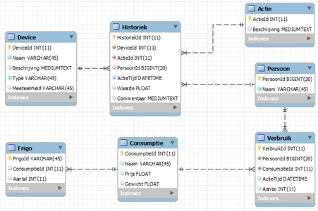

The main structure of the database are the tables Historiek (tracking of the sensors), Persoon (persons), Verbruik (usage of a person) and Frigo (what is in the fridge). You can also find a dump of the database in the repository in the directory Database.
Historiek
The database stores everything that the fridge measures in a table Historiek. He keeps the temperature of the fridge, when somebody comes to scan and if the fridge is turned on or off.
Persoon
Table Persoon stores all the customers of the fridge in his table
Verbruik
Links Persoon with a consumption and how many were taken and when.
Frigo
Stores information of how many consumptions are still in the fridge.

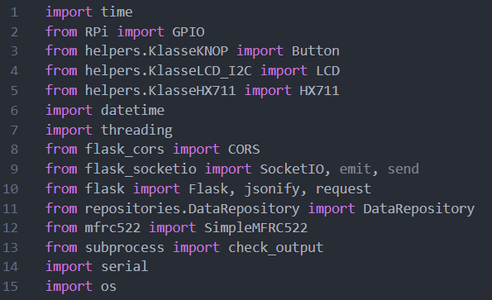

The main document of the backend is the app.py, you need to run this document if you want to get my project running. The backend uses Flask with Socket.io to handle communication with the frontend. This document also reads data from the sensors and write data do the actuators. It provides serial communication with the Arduino who sends numbers to the 4x7 segment display, you can send time from the PI or how many consumptions are taken out. It also provides communication with the RFID Read and Write Module through SPI, you can also send text to the LCD display with I²C. Of course, it also provides a change of weight on the scale of the fridge. The backend works with multiple threads that run from time to time, you can choose by yourself how long the thread has to wait. There is a thread for sending time serial to Arduino with the 4x7 segment display, a thread for reading the RFID Module and a thread for measuring the temperature every minute.
