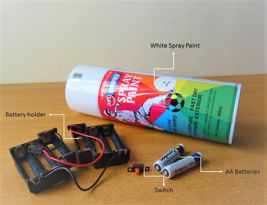

- 2 x AA Batteries ( Gearbest) these batteries will power the Arduino board
- Plastic Container (Gearbest) I found an old plastic container in which all the components could fit. The box is important as you can easily access the components and it's waterproof.
- Ultrasonic Sensor (Gearbest) An ultrasonic sensor measures distance. It will be attached to the lid indicating the quantity of trash. Our system's key component.
- Jumper Wires (Gearbest)
- Arduino MKR1000 (Amazon) The center piece is one of Arduino's latest micro-controller, which simplifies the task of connecting to the Internet using prebuilt libraries that can be downloaded.
- White Spray Paint Turn your regular box into a more professional product

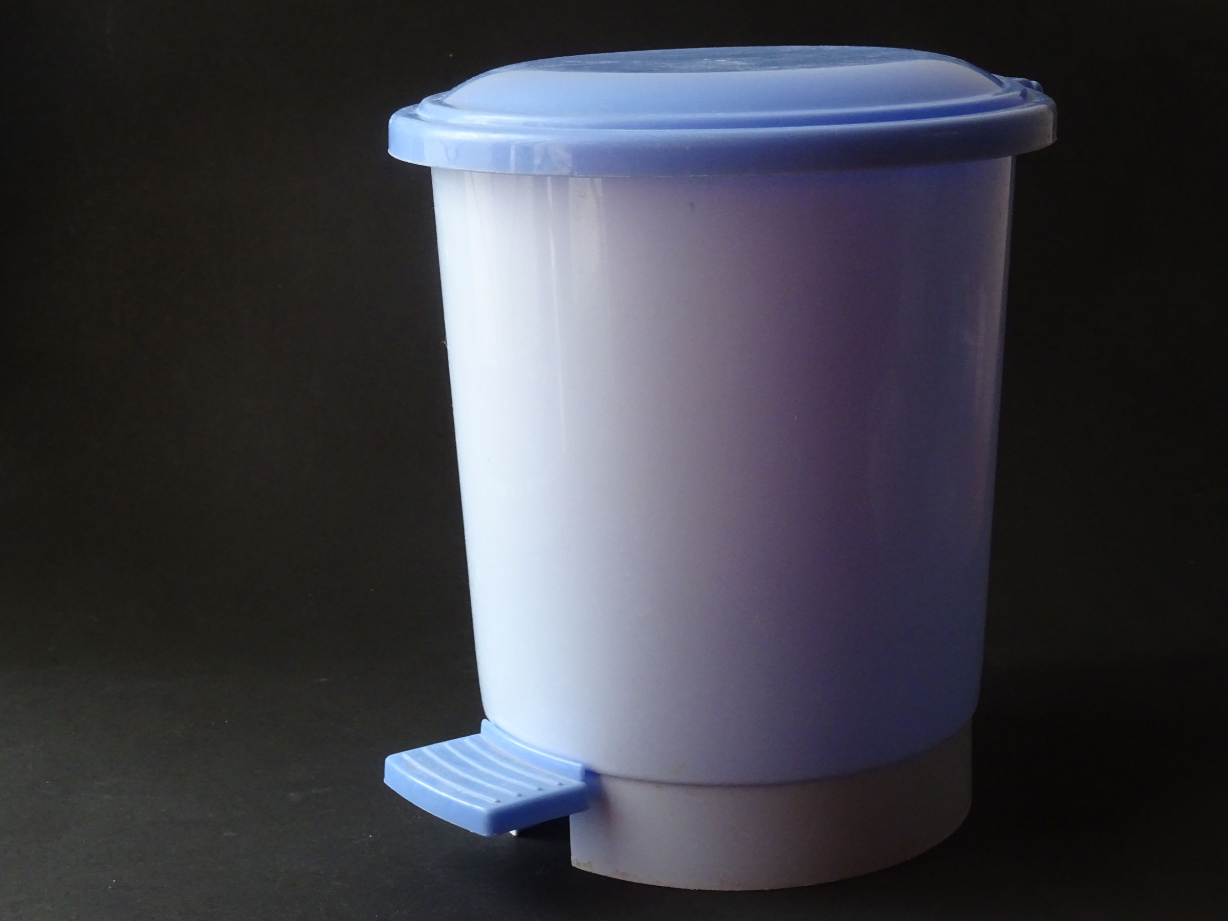

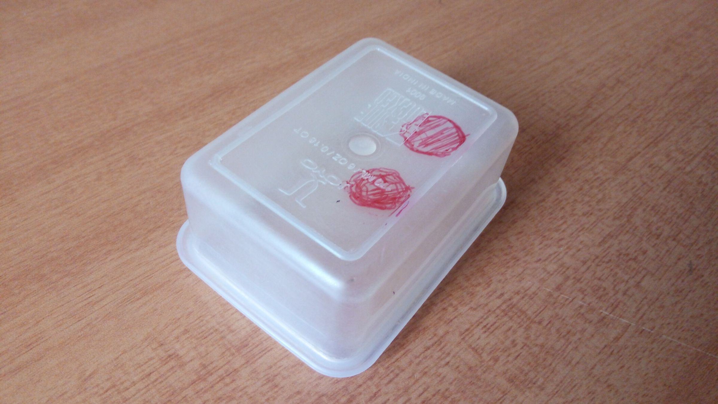

It's time to make our very own system to test our concept at home on a small scale! Look for an old small plastic container and make sure your components fit.

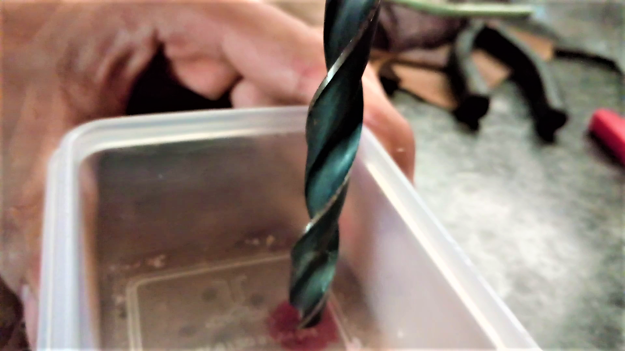

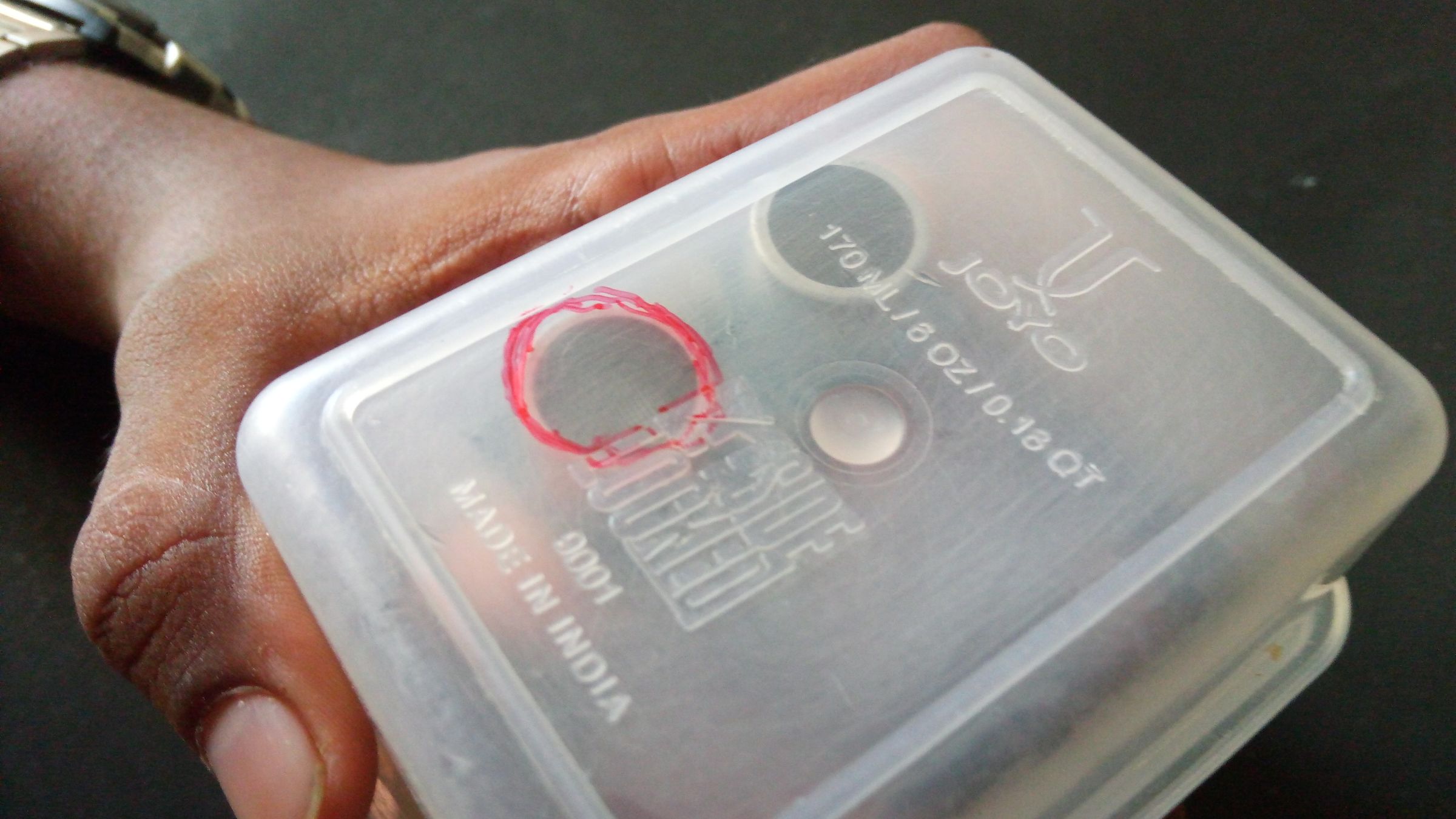

Now remove the lid and trace the two ''eyes'' of the ultrasonic sensor. this will be the side facing the bottom of the bin.
Take your biggest drill bit, mine was 10mm and drill out the holes. If they still are a bit small lightly file them till the ultrasonic sensor snugly fits in, completely flush to the surface.

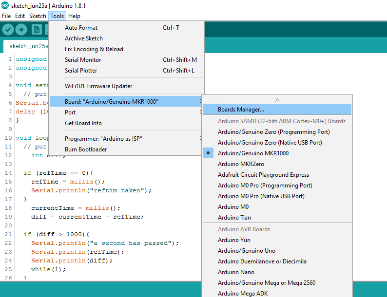

Step 8: Installing Drivers and Libraries Necessary
To be able to program the arduino mkr1000, you need to first install the drivers. To check if you already have them installed open the arduino IDE, click on tools then boards and look if either arduino or genuino mkr1000 are in the list. If they are there skip to next step, if not follow along...

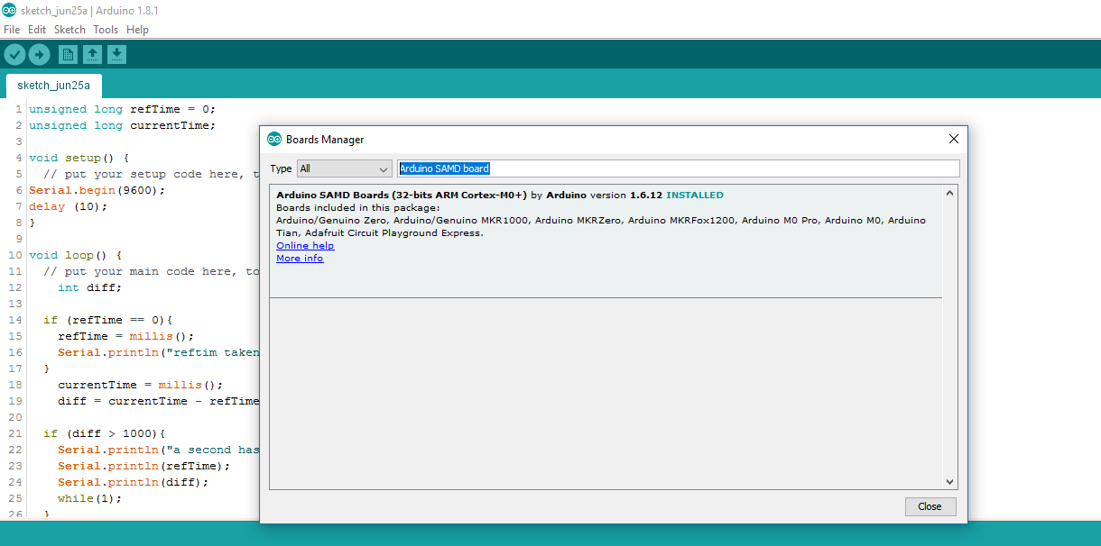

To download the necessary drivers to be able to use arduino mkr1000, open the arduino IDE again, click on tools, boards, then boards manager. Now in the search bar, search for "Arduino SAMD board", select your arduino IDE version and download the one that comes (double check with the picture below)

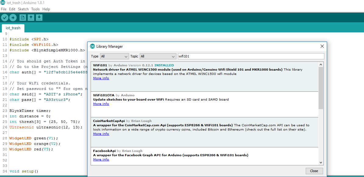

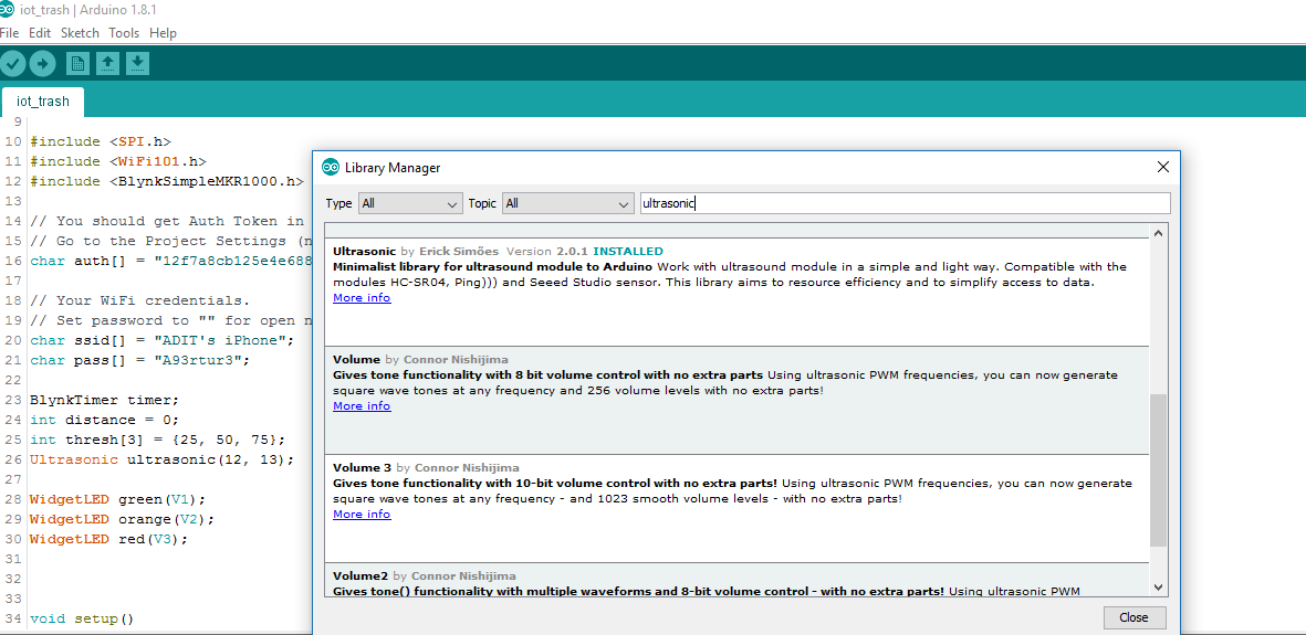

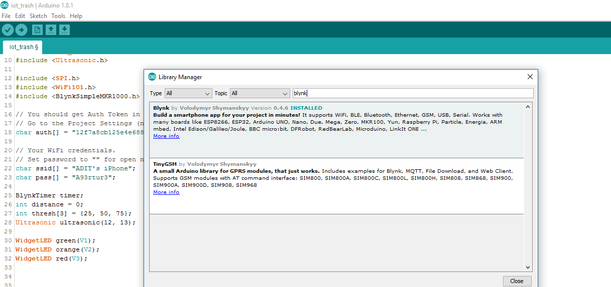

Once your drivers are installed, go ahead and download the libraries needed. For our program to run we need the WiFi101 library, the blynk library and the ultrasonic library, both can be found in arduino's in built library manager. Open to sketch then include library then library manager.
Nowin the search bar, search for wifi101, blynk and ultrasonic, choose your IDE version and install. (double check with the pictures below)

I took the house dustbin to test my model.

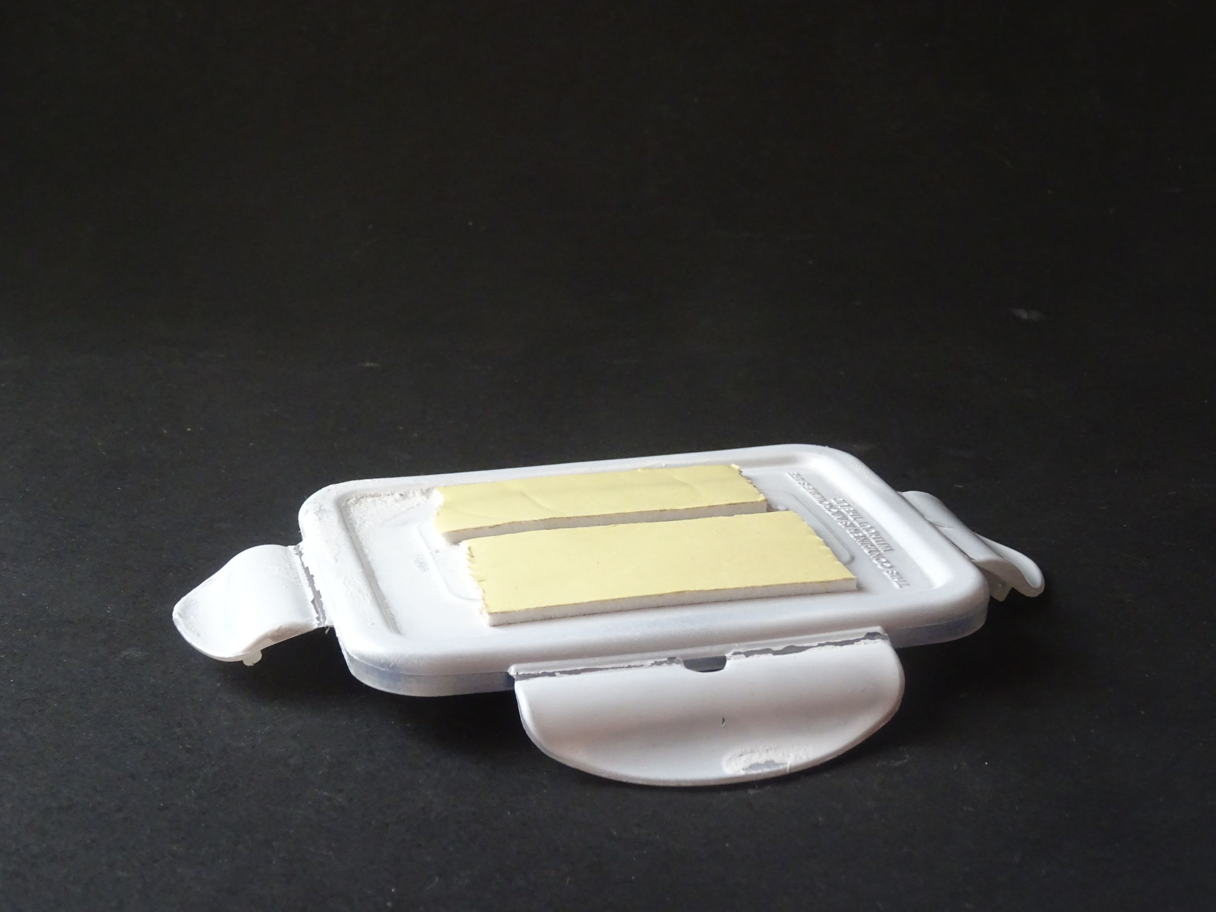

Cut and stick to pieces of double-sided tape and attach the system to the lid of the dustbin, making sure the sensor is facing downwards.

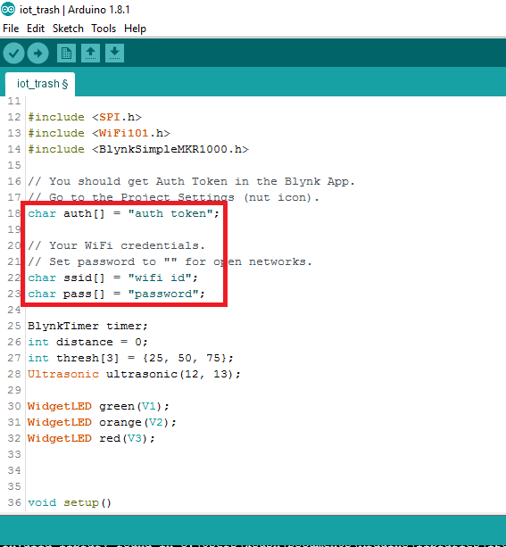

Once you are familiar with blynk and how it works, you can upload the program attached below. Some things you have to change in the program are :
- replace "wifi id" in line 22, with your actual wifi id
- replace "password" in line 23 with your actual wifi password
- replace "auth token" in line 18 with your blynk's authorization token which u should have received through mail while installing blynk

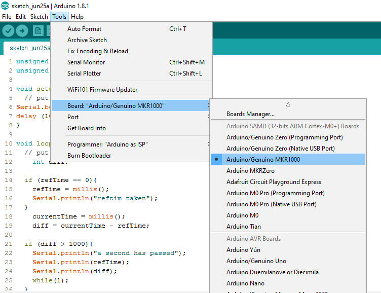

Make sure you have the right board type selected (arduino mkr1000) and the correct port. To setup the Blynk interface you need to use three virtual LEDs, lined up one on top of the other. (follow the picture below)

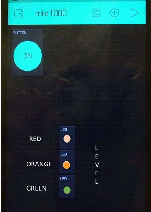

These are screenshots of my phone as I filled the dustbin. On the blynk application we aliggned three LEDs one on top of the other. Green which ranges from 0 to 25% full, Orange from 25 to 65% and Red from 65 to 100%
After having put 10% of trash and closing the bin we have the green LED that comes on the other two stay off.
50% full...
...and finally we put all the trash possible, and all three LEDs and a smile lit up! Congratulations the model works : )
