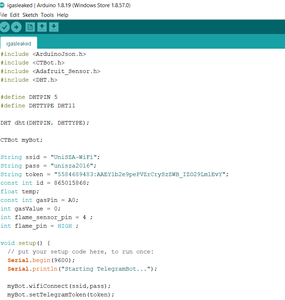

Step 3: CODE
  • Install ESP8266 Boards: (paste in Arduino preferences)
"https://arduino.esp8266.com/stable/package_esp8266com_index.json"
  • Install Libraries: (search for under sketch->include library->manage libraries)
"Sensor.h" - Adafruit
"DHT.h" - Temperature
"CTBot.h"-Telegram Bot
  • Code Changes:
Change WiFi SSID
Change WiFi PASSWORD
Add your previously saved Telegram Bot Token
  • Insert Micro SD Card and Upload Code

Programming the esp8266 Based Telegram Bot
10. Firstly, we start with importing the required libraries.
11. After that, we initialize the variables to store the SSID and Password of your Wi-Fi.
Note: define the variables for holding the bot token and chat id. You need to put your credentials in these variables. Done setup Telegram Bot. Upload the above-mentioned code to your esp8266 board through Arduino IDE.
After uploading the sketch, press the EN/Reset button on the board, so that it starts executing the code. Open the serial monitor, and wait to get connected. Now, open Telegram and start a conversation with your bot by going to the link provided by Botfather and typing /start.
