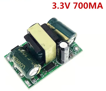

Step 2: Power the Remote Control
The remote control obviously needs to be powered. By default, most remote controls use a CR2032 battery which has a very low capacity in terms of mAh. Furthermore, extreme winter temperatures further reduce its capacity. Therefore, it is necessary to install an additional power supply (3V 700mA) to always have maximum signal performance in all conditions, which is crucial in my case because the remote control will be located far from the gate receiver. To do this, we need to identify the +3V and GND of the original battery (white/green and green wires).

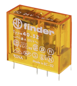

Step 3: The IoT Relay
I used an old eWelink relay, but it had a problem: it wasn't a dry contact. Therefore, I had to install an additional supporting relay. I used a finder relay 40.52.8.230.
