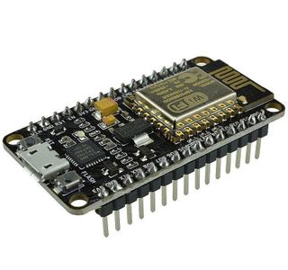

  • 1 x ESP8266 NodeMCU module

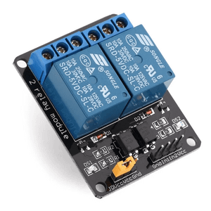

  • 1 x 2-channel relay module, 5V, 10A

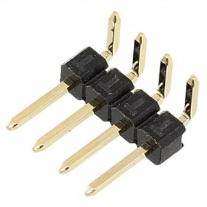

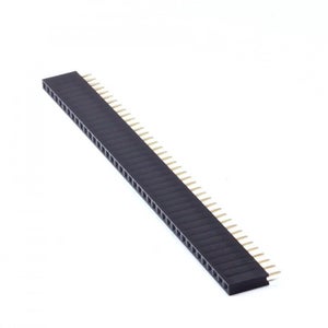

  • 4 male pin headers
  • 2 x 20 female pin headers

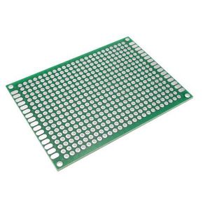

  • 1 x Perforated board (5x7 cm)

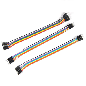

  • Some wires

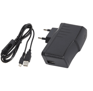

  • 5V power adapter

The relays module and the ESP8266 are connected as follows:
  • Com -> input 8 +24V
  • NO (relay1) -> input 1 Start
  • NO (relay2) -> input 7 Pedestrian
  • GND -> GND
  • VCC -> +5V
  • In1 -> D1
  • In2 -> D2

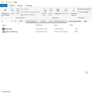

In the same folder as smart_gate_opener.ino you should create a new folder with the name data, inside that folder create a new html file index.html with the following code:

You must downloadthe jquery library ( jquery-3.6.4.min.js) from the following link:https://jquery.com/download/ and save it to the data folder, now your data folder should looks like that: folder_tree.png
You need to use an older version of Arduino IDE, for example, version 1.8.19, to be able to upload the contents of the 'data' folder using LittleFS
