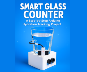

Introduction: Smart Glass Counter - a Step-by-Step Arduino Hydration Tracking Project
We all know water is essential for our health — but in the middle of busy day, it's easy to forget to drink enough. The Smart Glass Counter is my solution to this problem. It uses sensors to detect when you have taken a glass of water, keeps count, and even reminds you with sound signals if you're falling behind.
The project is powered by the Arduino UNO R4 Wi-Fi, an IR sensor, and an XKC-Y26-V contactless water level sensor, along with a buzzer for sound notifications. Once you've reached 6 glasses in a day, it plays a victory tone — motivating you to keep up the habit.
