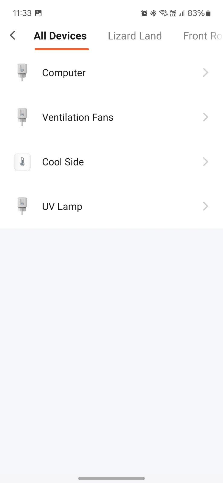

Each of the devices will be connected into a Tuya Smart plug device, this will allow you to control when they are on and off.

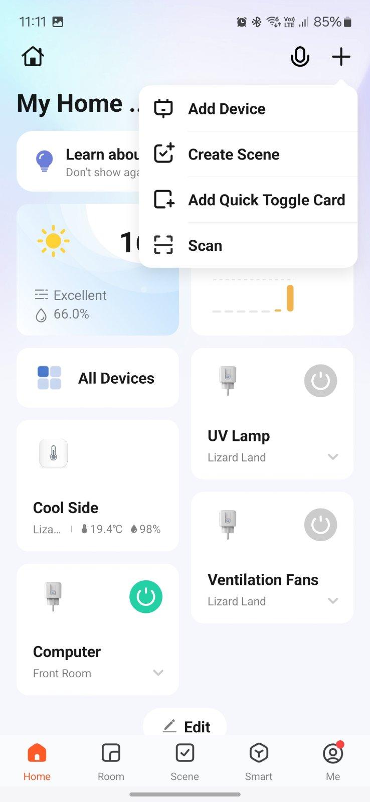

Open the Tuya Smart app, and for each smart device select the '+' button and select 'Add Device' and follow the prompts to complete the device setup. You should give each device a name that reflects what it's function will be, eg: 'Basking Lamp", "UVB Light" etc...
Finally, create a 'Room' for all the devices in the given enclosure and give it a relevant name. I named mine 'Lizard Land'. This is important if you have more than one enclosure.

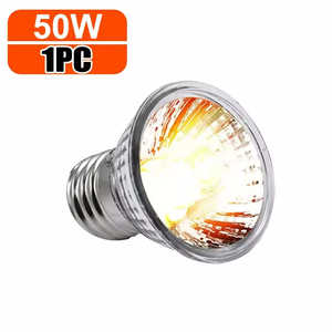

Basking lamp
This lamp is a more focused bulb that will deliver more heat into a concentrated area where the lizard can bask. This should be at the designated 'hot' zone, typically above a rock or piece of wood.

Using the same process, add the sensors into the Tuya Smart app and add them into the room you created earlier.

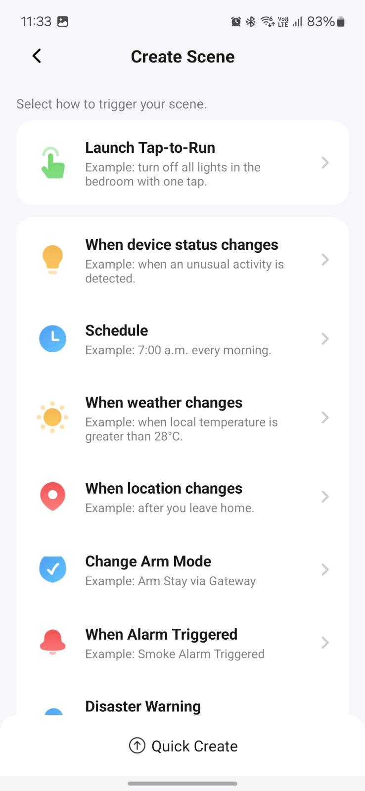

Step 4: Configure Tuya Automations
Use the Tuya Smart app to create the following automation by going into the 'Scene' menu and selecting the 'Automation' option.

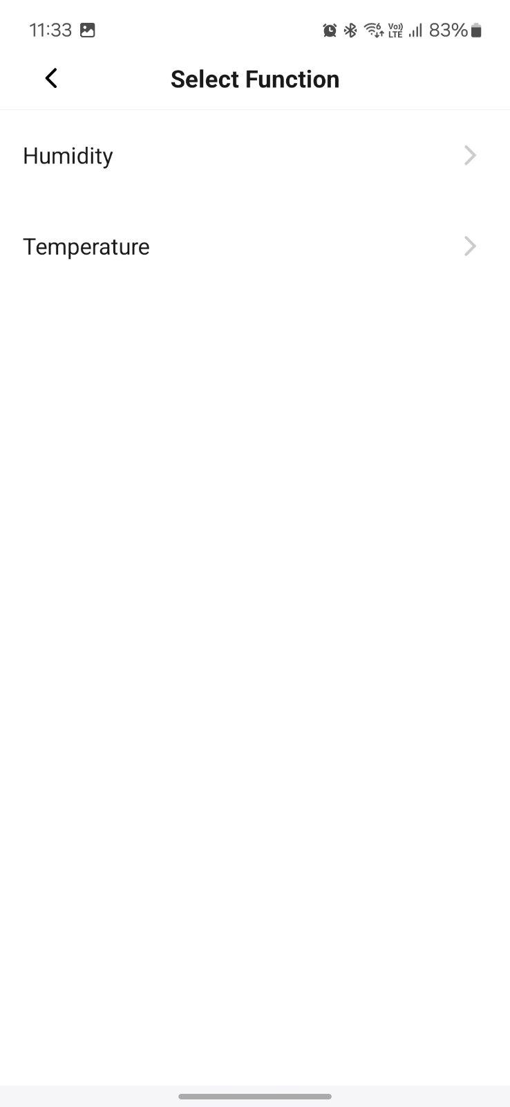

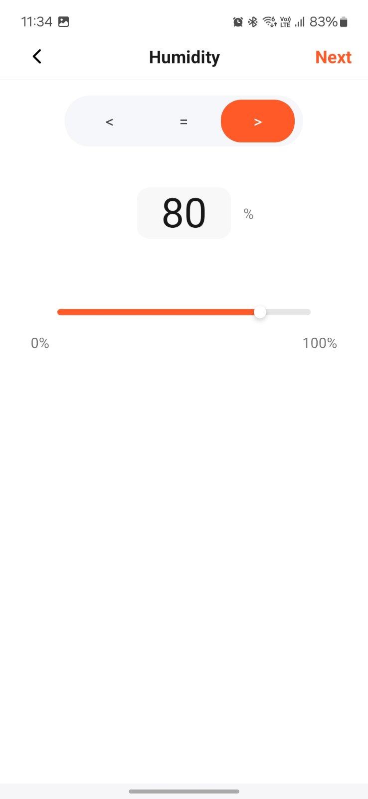

Start by using the 'Create Scene' button and then 'When device status changes' and select the temp and humidity sensor
I used the following logic for my set up
🌡️ Temperature Control
  1. IF temperature > 28°C → THEN turn on fan
  2. IF temperature < 15°C → THEN turn on basking lamp
  3. IF temperature > 30°C → THEN send alert (danger zone)
  4. IF temperature < 5°C → THEN send alert (danger zone)
💧 Humidity Control
  1. IF humidity > 80% → THEN turn on fans
  2. IF humidity < 60% → THEN turn on humidifier/mister (I'm still developing this)
