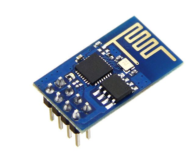

Introduction: Smart Heater on ESP8266, AWS IoT and Mongoose OS
This is a "Smart Heater" example: the heater device reports current temperature, responds to the status requests and to the heater on/off command.
Prerequisites:
- Hardware: ESP8266 NodeMCU
- Google and/or Facebook accountAmazon
- AWS accountAmazon's aws management utility (see https://aws.amazon.com/cli)
- Mongoose OS (www.mongoose-os.com)
Architecture: See on the image above.
The data flow is as follows:
- A device uses I2C temperature sensor and sends data to the AWS IoT periodically
- An AWS IoT rule intercepts temperature data and stores it into the DynamoDB table
- A device gets synchronised with its AWS IoT shadow
- A frontend with OAuth is running on AWS S3, talking to the device shadow to either get the device state, or set the device state (turn it on/off)
Detailed instructions:https://mongoose-os.com/aws-smart-heater.html
