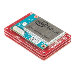

The hardware can be built using the schematics provided by Sparkfun or by purchasing their boards.
Build From Schematics:
Intel Edison:
http://www.intel.com/support/edison/sb/CS-035272.h...
Edison Console & External Power:
https://cdn.sparkfun.com/datasheets/Dev/Edison/Ba...
LSM9DS0 "9 Degrees of Freedom" IMU Edison sensor module:
https://cdn.sparkfun.com/datasheets/Dev/Edison/9d...
Optional Battery*
https://cdn.sparkfun.com/datasheets/Dev/Edison/SFE...
OR
Purchase Project Modules:
https://www.sparkfun.com/products/13024 Intel Edison
https://www.sparkfun.com/products/13045 Sparkfun Baseboard
https://www.sparkfun.com/products/13033 Sparkfun Edison 9DOF
https://www.sparkfun.com/products/13037Optional Battery*

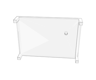

3D Printed case was made for us thanks to @MattStultz from www.3dhubs.com the printable files (Impact.stl & ImpactTop.stl) are attached and I highly recommend using their services. The case can house the Intel Edison, Sparkfun Baseboard or battery and the 9DOF and includes a slot providing access to both USB connectors for use with an external power pack, console or other sensors.

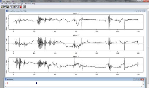

Optional:TeamImpact.R (File Attached) - R script for analyzing real time and prerecorded data. For troubleshooting sensor data and interpretation by medical personal or artificial intelligence.
