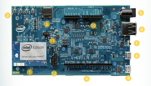

By now you should be familiar with your Arduino Expansion board parts.
To refresh your memory please visit http://www.intel.com/support/edison/breakout-bd/sb/CS-035653.htm
Step 3: Assemble of Board

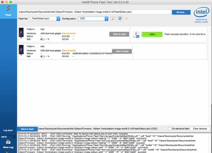

If this is your first using your Arduino Expansion board and Intel Edison please follow the ‘Assembling the Intel® Edison board with the Arduino expansion board’ tutorial to get your board assembled and ready for use. -Assembling the Intel® Edison board with the Arduino expansion board https://software.intel.com/en-us/assembling-intel...
-Driver installation and updating firmware (enter link https://software.intel.com/en-us/installing-drive... -Updating firmware with ToolLite https://software.intel.com/en-us/installing-drive...
-Flashing for mac https://software.intel.com/en-us/installing-drive... Once you successfully updated your firmware in a terminal follow the next steps:

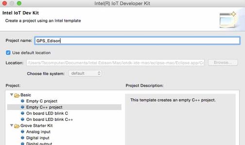

Step 4: Creating Your Project in Eclipse C++
1. Launch your Eclipse C++ and Navigate to “File > New > Intel IoT C/C++ project”
2. Enter a name for your project (note no spaces are allowed).

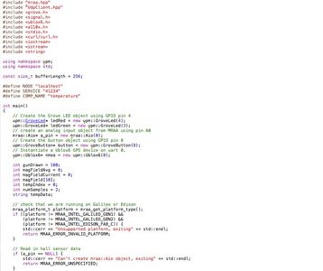

Step 5: Getting the Code Ready
Below is a snipet of the code used.Please note that there is also an LED and button being used in the code along with integration with FireBase.
Full code for the GPS, Hall sensor and LEDs its at https://github.com/tsmilesagain/safety_holster

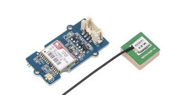

The GPS sensor:
The GPS sensor is linked to the UART input of the Base Shield (included in the Grove Starter Kit Plus). Once connected you should see the green light on the sensor turned on, this indicates its properly connected and receiving power.
