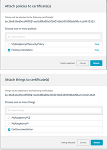

Go to the certificate that you just created, click on the 3 dots and click on attach a policy and choose the policy that you have just created and attach it.
Now click on the 3 dots again and click on attach a thing and choose the thing you have just created and attach it.
