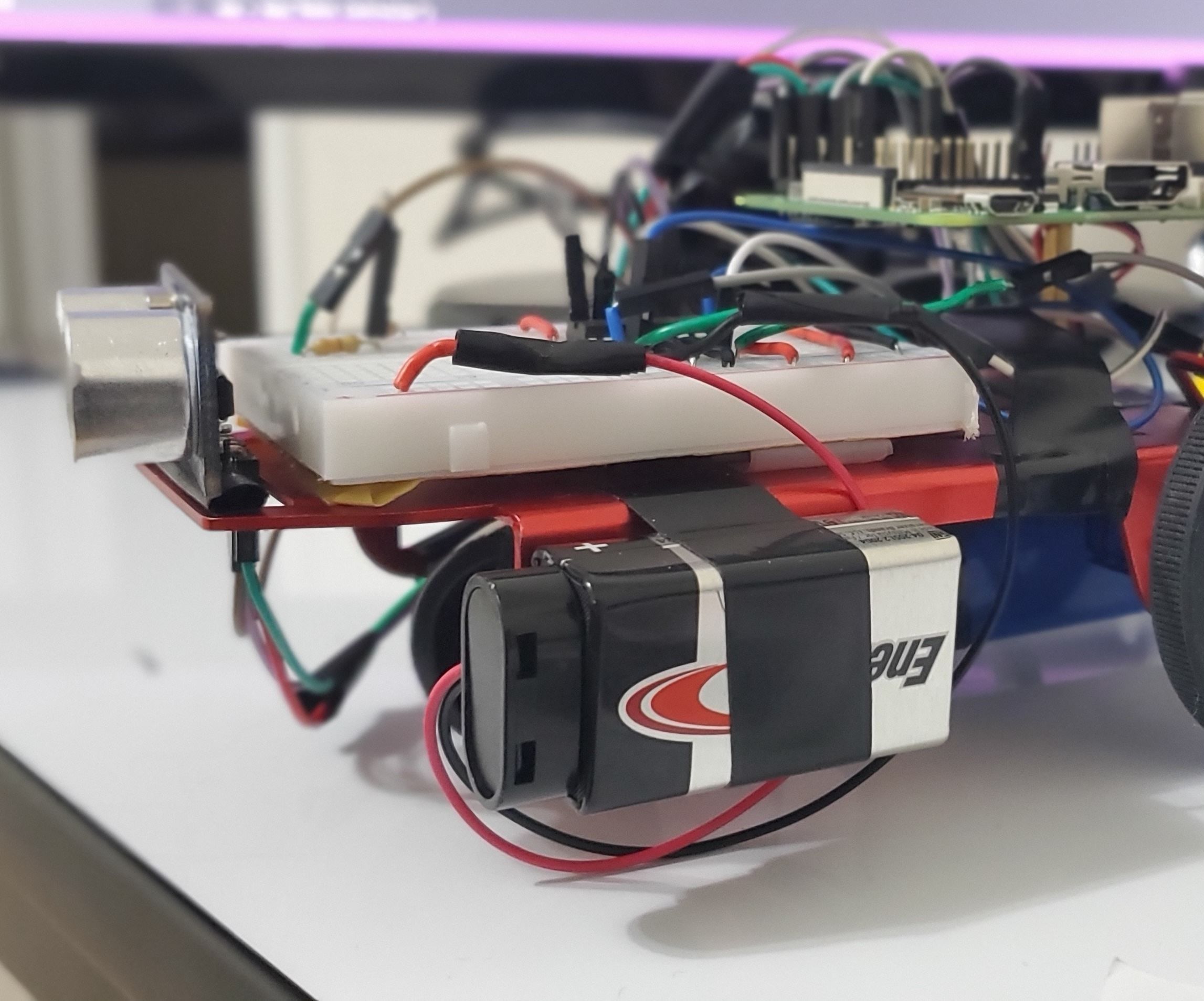

Step 4: Adding Functioning Push Buttons to Control the Motor
As Shown above connect two pushbuttons to the Arduino on a breadboard which control the motor (Code showed after)

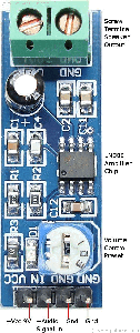

Step 5: Connecting the Speaker
By using the LM386 Module and connecting the wires (Ground, power and pin 3(HAS TO BE PIN 3) to the arduino). The Speaker has been connected to the Arduino.
